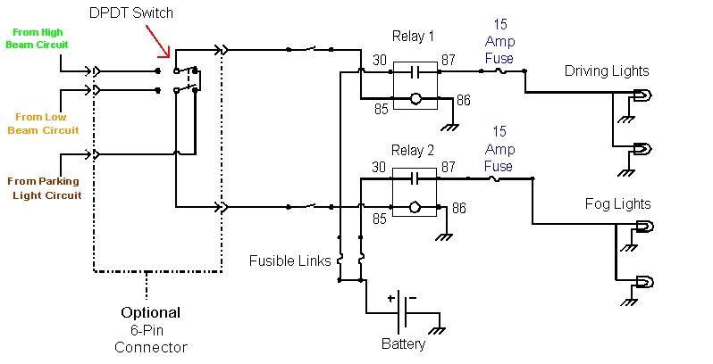

I need some help making sure I get this right.... do I have Switch Green and Blue correct?
Switch to Harness:
Black to Black (ground)
Yellow to Add a fuse?
Blue to White? Source w/in-line fuse
White to Blue? Connect to relay
I bought the MicTuning 32” LED light bar, the MicTuning Heavy Duty wiring harness, and MicTuning Toyota Push Switch.
This help at all?

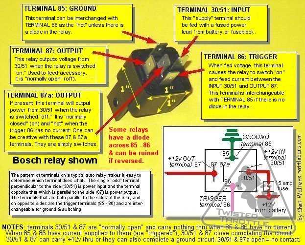

This help at all?
No, I could not make sense of the diagram. The harness came with a switch like what you shared, but I’m using the MT Toyota push button, with the green connector.
