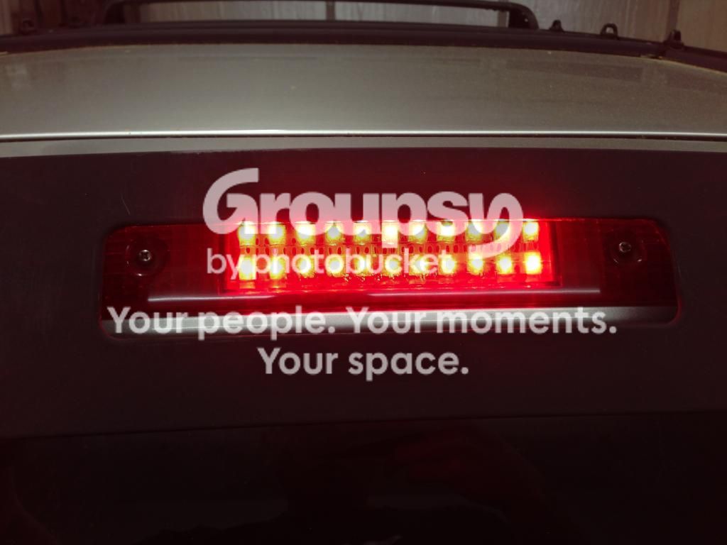

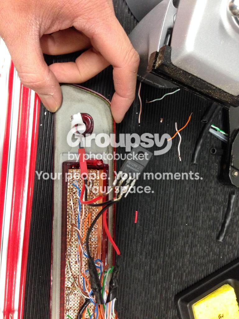

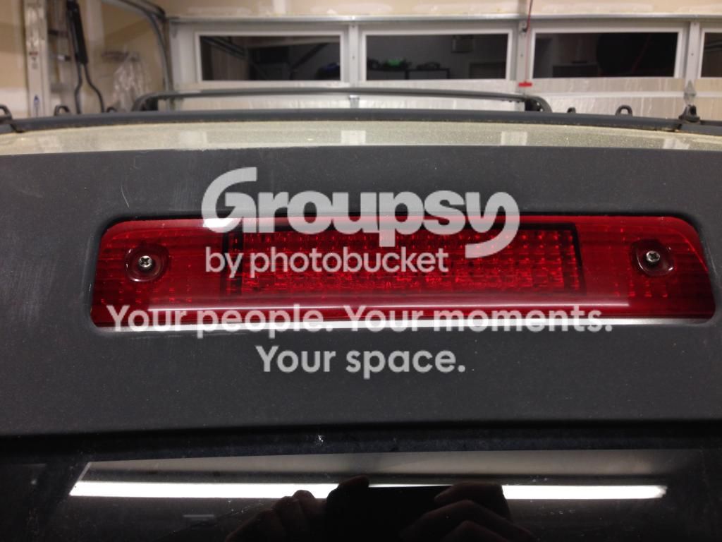

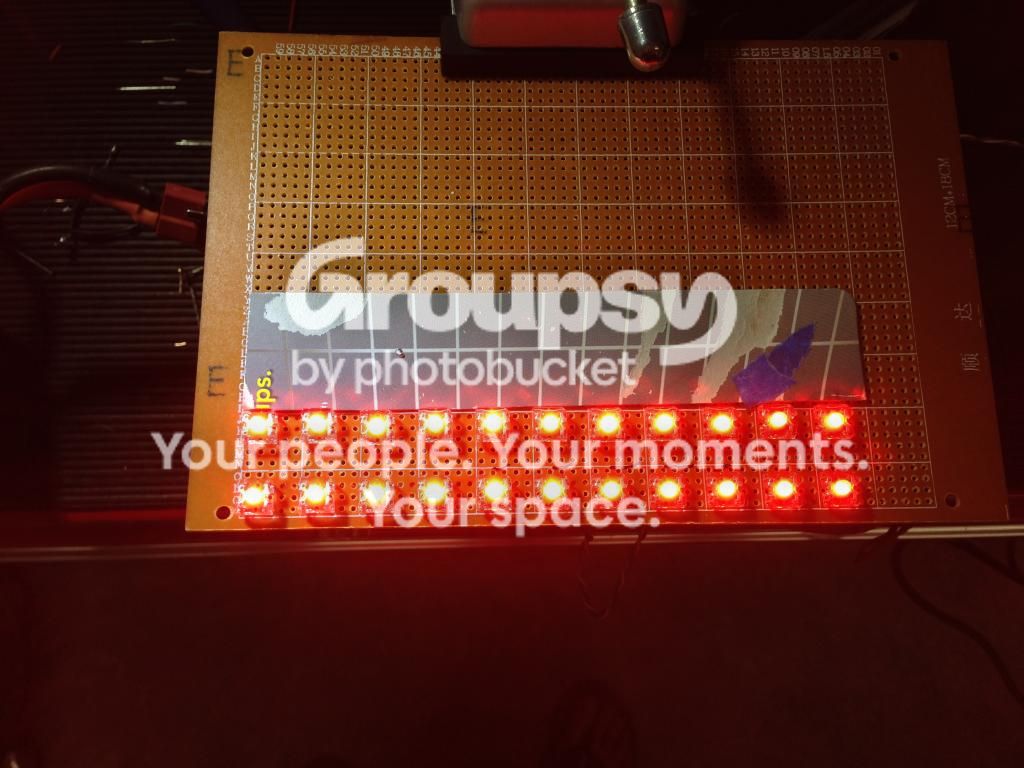

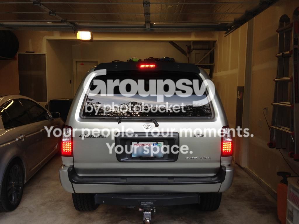

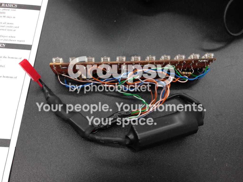

The red lens ones with the 4 large LEDs is the closest I've seen to OEM short of making your own. I soldered my own earlier this year. Definitely a learning experience and took me a couple of afternoons. I would say it is medium difficulty. There were some guides I found from google that help calculate the resistance needed. I spent half the hours reading up on it and the other half doing the work.
I bought an LED pack, circuit board PCB, 12v Voltage Regulator, and Resistors to reduce the current in order to not burn out the LEDs. Basically, I cut out the PCB to the shape of the housing using cardboard cutout as the starting place. Then determined the array of LEDs desired, and soldered it all up and inserted back into the OEM housing. All parts can be sourced on ebay.

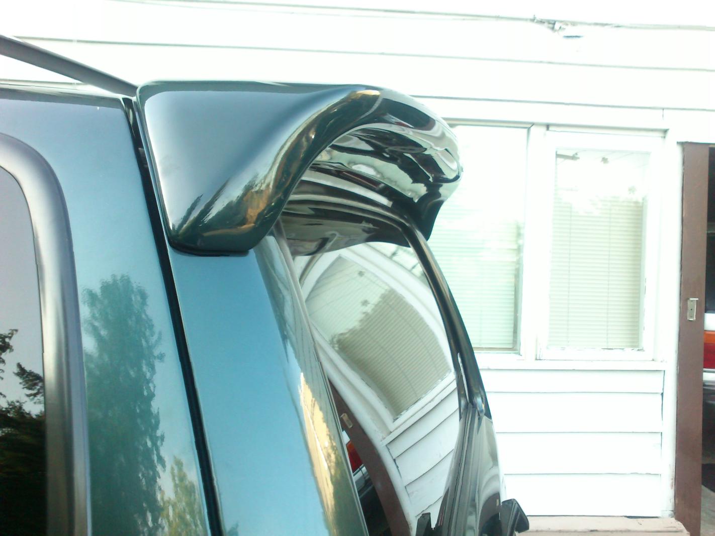

another idea is a JAOS spoiler.......
comes with a super bright led strip.

I can start with a parts list:
Sharp PQ12RF21 Qty 1
LEDs - I used 22 total of the HPWT--DH00-F4000
LED HPWT-DH00-F4000 HPWT-DH00 Bright Red/Orange SuperFlux LUMILEDS Qty of 25 | eBay
Pcb board
12pcs KIT Prototyping PCB Printed Circuit Board Prototype Breadboard Stripboard | eBay
Resistors- the ohm rating of 47 ohm and 1/2 watt was calculated based on number of LEDs you're planning to use. I used this for 22 LEDs from an online calculators I found awhile back. I don't remember the link though.
100 x 47 Ohm Carbon Film Resistors - 1/2 Watt - 5% - 47R - Fast USA Shipping | eBay
For electrical wire, I used solid strand CAT6 I had on hand
I will try and give more details another day when I have more time on my hands. Again, all parts came from eBay.
Here's is a good write up from toyotanation:
http://www.toyotanation.com/forum/1...01/321986-diy-custom-led-3rd-brake-light.html
The only difference in process is that he painted his board black and did not use a Sharp 12v voltage regulator. It's not necessary to use the regulator but cheap insurance because it'll keep the voltage constant at 12V despite the vehicle being 12.6v off and 13.6-14.4 when turned on. Technically, without the voltage regulator, I'd probably calculate resistors ohm required based on 14v instead of 12v.
