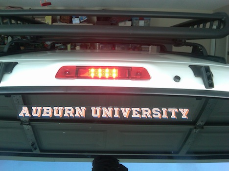

I have the OEM eBay one. It works great and looks good with my LED tails. Only thing is my ABS light came on and I also had to run some clear caulk around the inside part of it so water wouldn't get into it. It doesn't quite seal like the original does. The ABS light is fixable with a simple load resistor.

i just bought one and it came in two days! i got the smoke one and haven't installed it yet. But yeah it definitely needs to be sealed
ive heard resistors produce a ton of heat and can damage your paint so for me i think im just gonna tap into the original wires and leave the bulb off to the side somewhere
