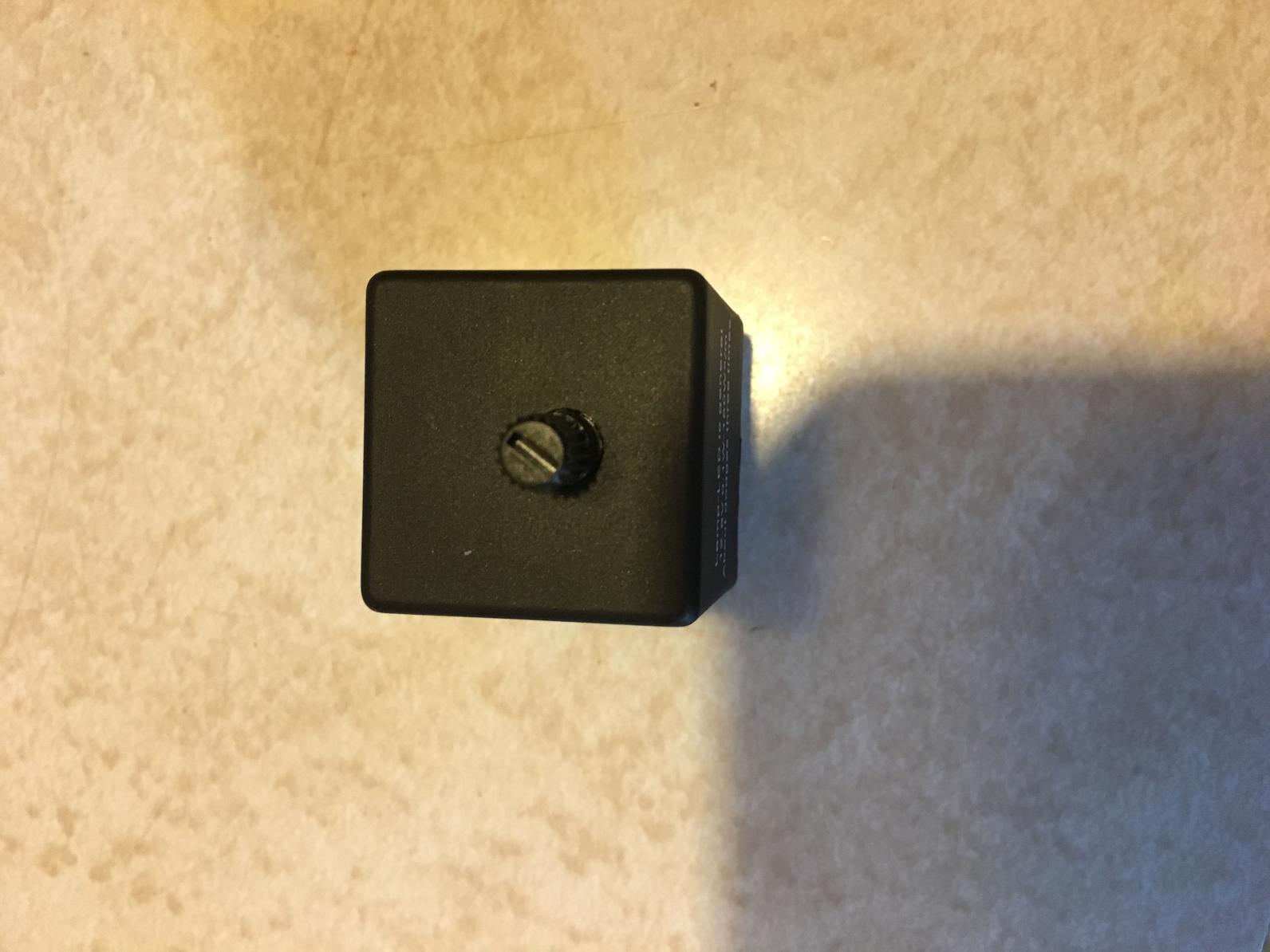

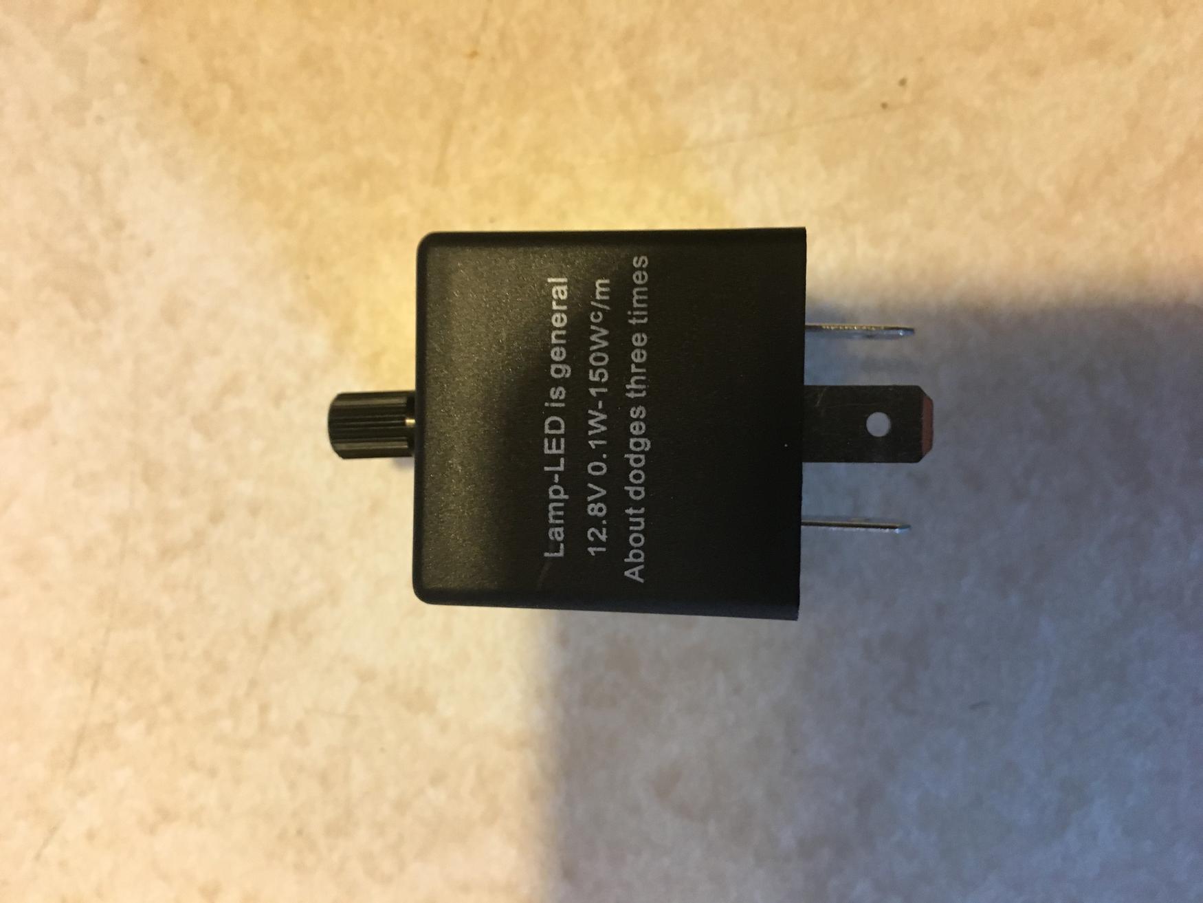

Well, I ordered the above listed part, and it came in a white box. There is also a inob on it. I've never seen a relay with a turn knob on it. What is the purpose of it??
As he mentioned earlier, to change the speed of the blinking most likely.
