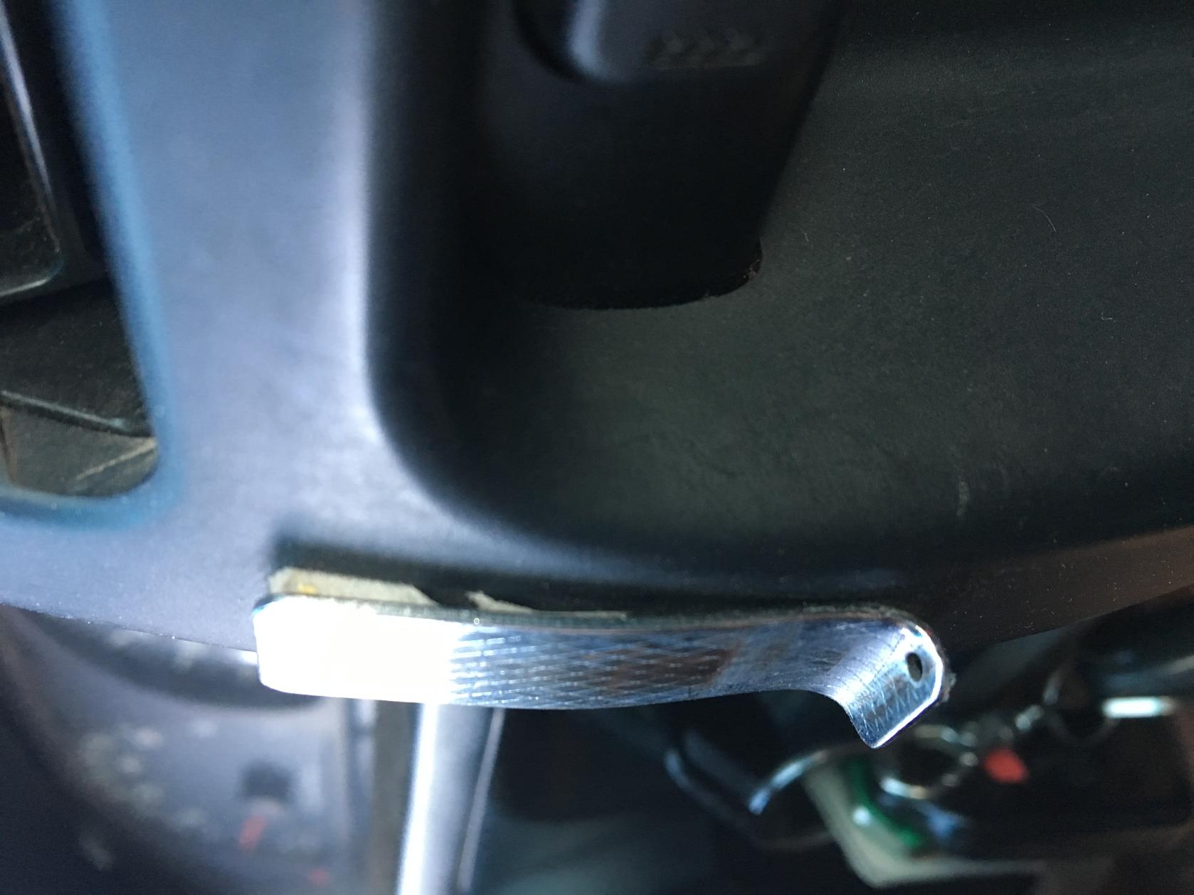

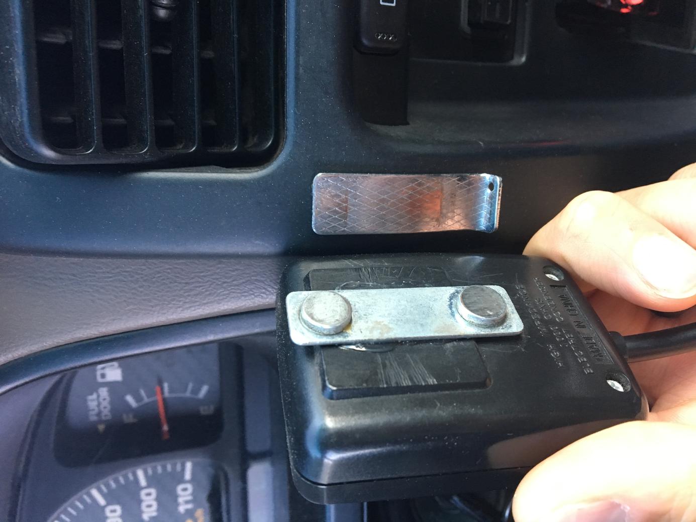

Here is a close up like you asked. I simply took an old name tag and glued it on. Added a little flare to the metal part so it doesn’t slide down. All the rough roads I’ve been on and it’s never fallen off.

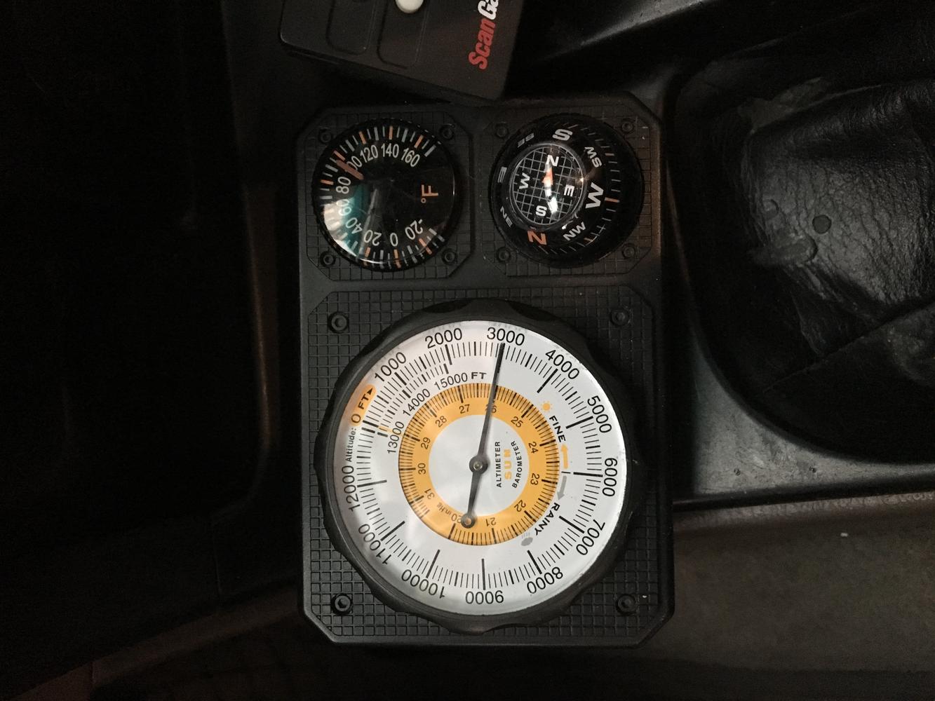

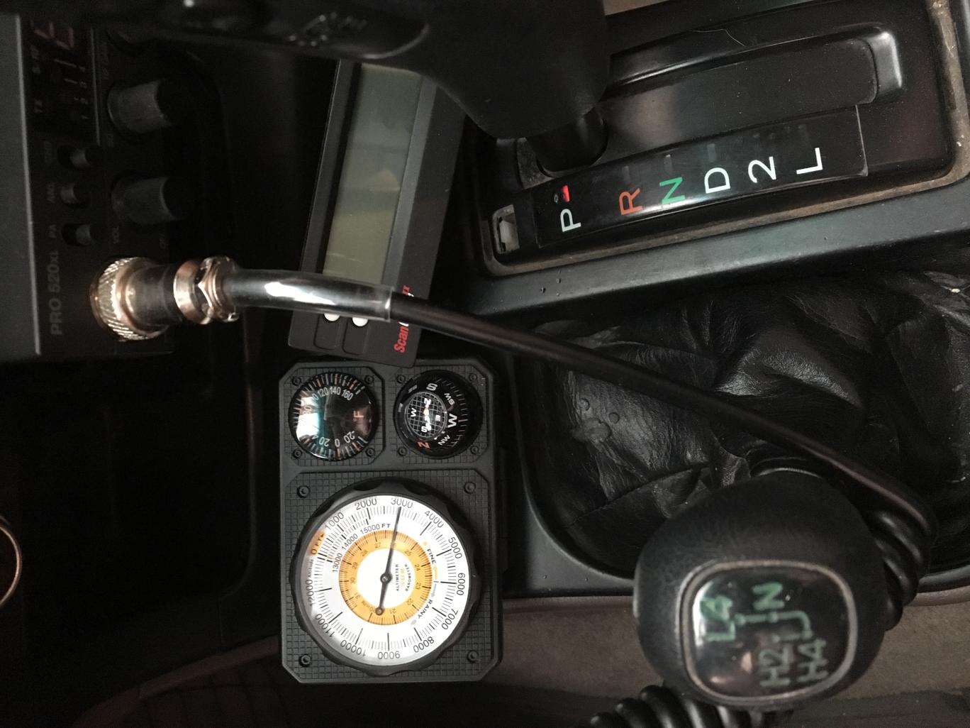

Could you post another picture of the altimeter and those others next to te shifter? I really want a mounted compass. Nice choice of CB!
This is a Sun Company altimeter. It works amazing and is fun to watch. I live in Northern Arizona so any given day I can go from 3000-7500ft. When ever I check it against a road side sign (or map or other device) it’s always within 100 ft so it’s incredibly accurate.
However the compass and thermometer are not accurate at all. If interested I would buy the altimeter only. It’s also $20 cheaper.

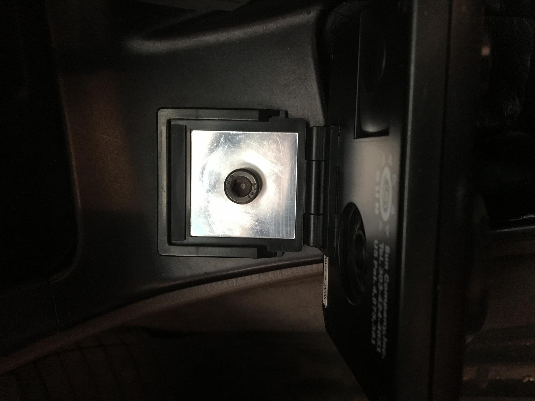

I wanted it to be removable for back packing so I have a nut glued to the trim (inside) and a hex head to easily turn with my fingered.
