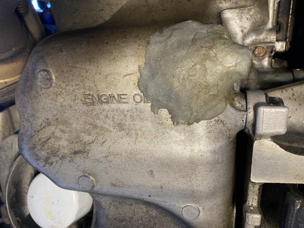

This was recently posted on another forum I belong to. The poster noticed a few drops of oil in his driveway after visiting a quickie oil change place. The drain plug was overtightened and cracked the oil pan....JB weld was used to "fix" the issue....luckily the owner noticed it right away and held the shop accountable.
