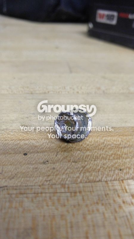

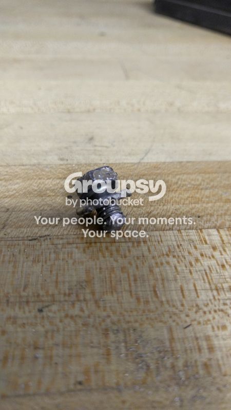

4. Pulled Timing cover again and held it out of the way of the fan and belts, ran for about 2 minutes. Sounds GONE. Put the cover back on and cannot reproduce the sound. At this point it was dark and late. I went home. Fast forward to today, I found a bolt sitting on top of my Trans cooler lines directly below the crank pulley.
New theory - I think there was a bold loose that was flopping around in my timing cover area and it flew out while I was running with the cover over.
So I need your help guys. Where does this bolt go? Pictures and video below.

So I found it. Good call on the plate behind the pulley.
If you look real close, the other bolt is pretty banged up. I bet the bolt was just flopping around in the pulley. I think once I shut it down, the bolt would settle at the bottom of the cam pulley. Then once i started the engine, the bolt would bounce around until the rpms got up high enough for it to be centrifugally forced to the outside of the pulley and then was quiet. The other bolt got knocked around on start up.
At least it is mostly a non-issue. I will grab a new bolt and slap it in. I think i am going to take the others out and put some lock-tite on them as well.
Thanks for all the help!

That probably would have been some good information. its a 10mm Hex head. I think its an M6. Its a fairly small bolt. More like it hold a sensor down type bolt.
Well... crap. If it's that small, you're right - it's just holding something small on as well.
I'm not sure anymore!
Then again, I did find a nice 12mm snap-on deep socket in my skid plate when I had it off the first time... so anything is possible!
Looks like the type of bolt Toyota uses on a lot of engine bay related things. Anything that screws down into the inner fenders or firewall will use that kind of bolt, as well as anything that bolts to the intake manifold.
Look like on that hold down parts of the wiring harness or a sensor or and block ground. Looks to be a common bolt they use for that type of stuff
Sent from my iPhone using Tapatalk Pro
If I remember correctly- the timing belt tensioner is held on with 10mm bolts, but I believe these bolts have the washer incorporated into the head. I also think that all of the water pump bolts have the washer built in. I suppose there is always a chance that they were swapped with non-original parts during a change though.
If the sound went away when the timing cover was removed then I'd be reasonably confident that it was from something in there.
After re reading the most important part of the post - the part where you said you removed the timing belt cover and ran it and the noise stopped and you found that bolt the next day - I would make sure everything is secure in that area. It's been a while since I did mine but really any bolt missing in there would not be good. For instance, it might be the bolt that holds the camshaft sensor on. Don't want that flopping around in there. Or, as someone else mentioned, the TB tensioner bolts. Furthermore, you probably want to see if any damage was incurred with that sucker flying around in there.
This is exactly what i have been thinking. The water pump bolts look to big for this one. I saw the bolt for the cam position sensor but I didn't know if it has two bolts or a single bolt and a locator stud.
Right now, I am confident its from in the timing cover.
In my case, it was the one on the right.
I think if you take out one of those bolts you'll see it's quite different. They have a shoulder on them and are at least 1/4" longer.
