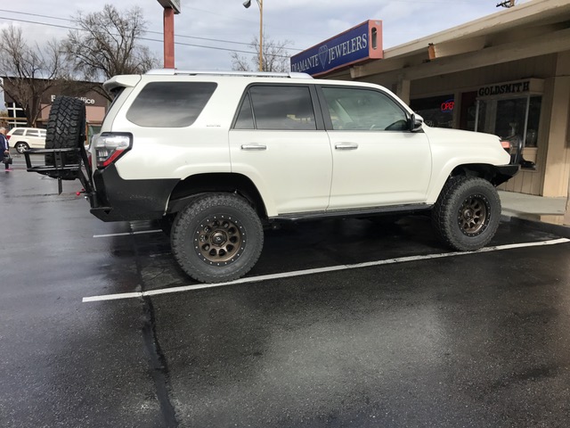

Buds. They don't look quite this pretty anymore because they do actually get used from time to time. PS: I have hi-lifted the truck by these sliders on a few occasions, and the full weight of the vehicle has sat on them on several occasions. They are good kit.

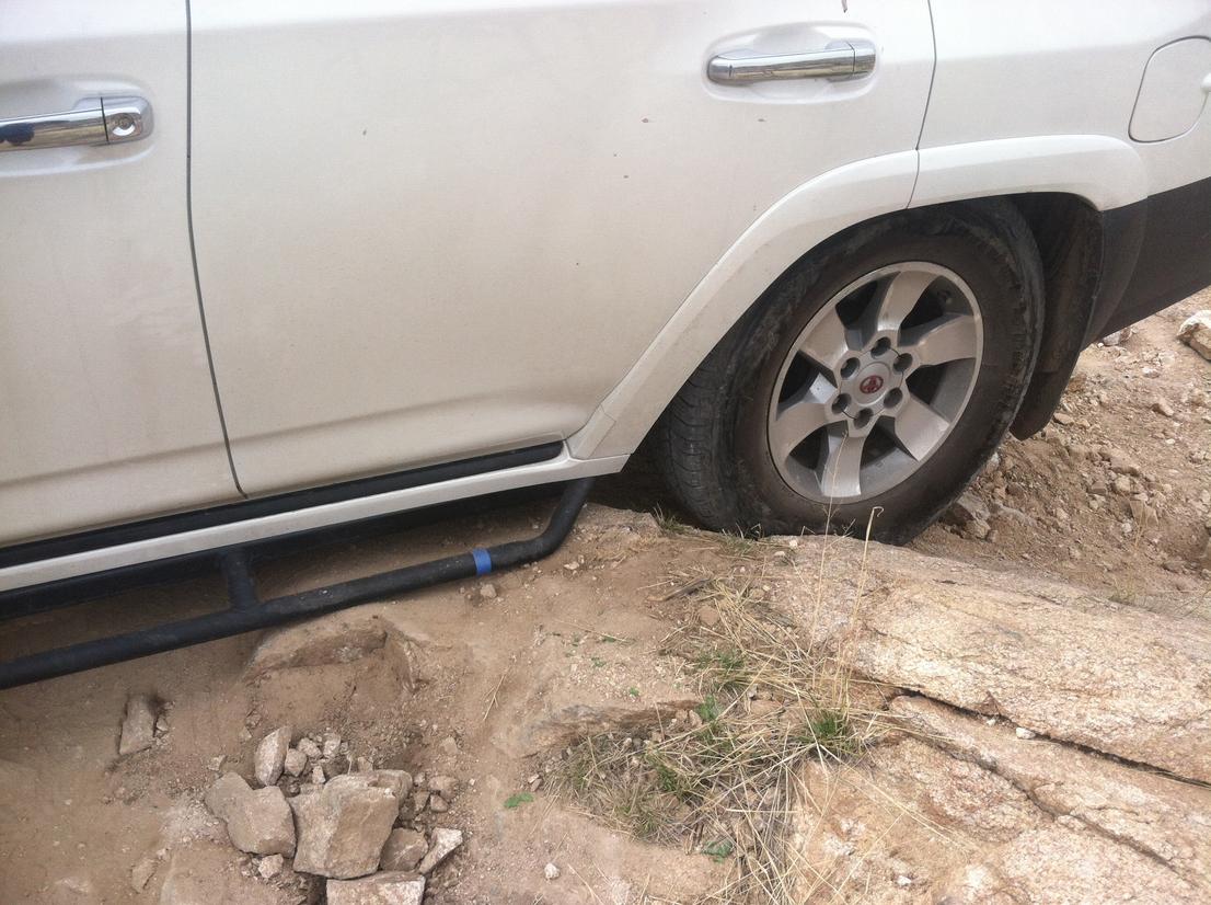

Love my Metal Tech's

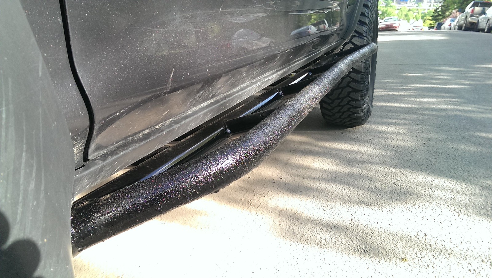

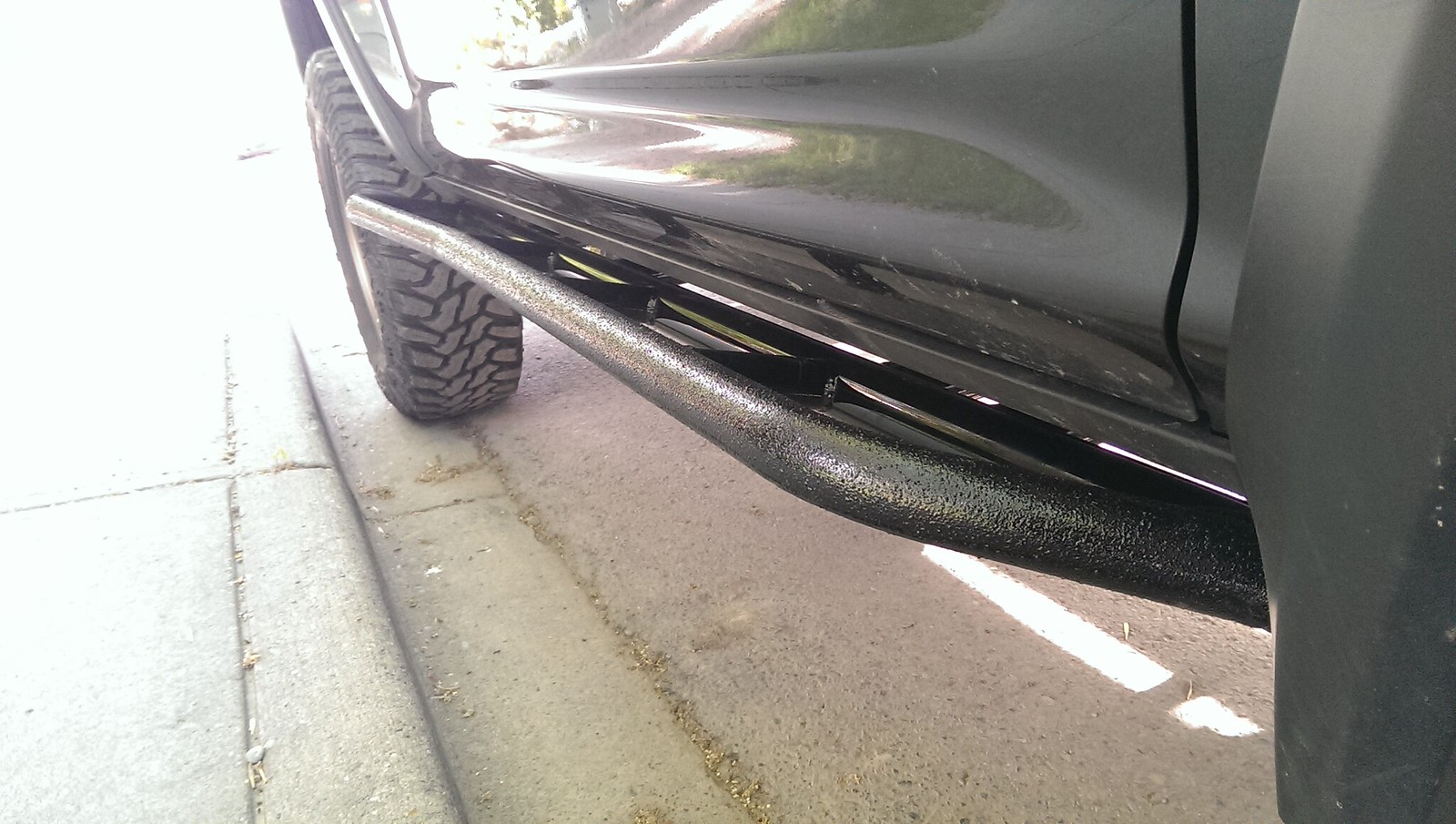

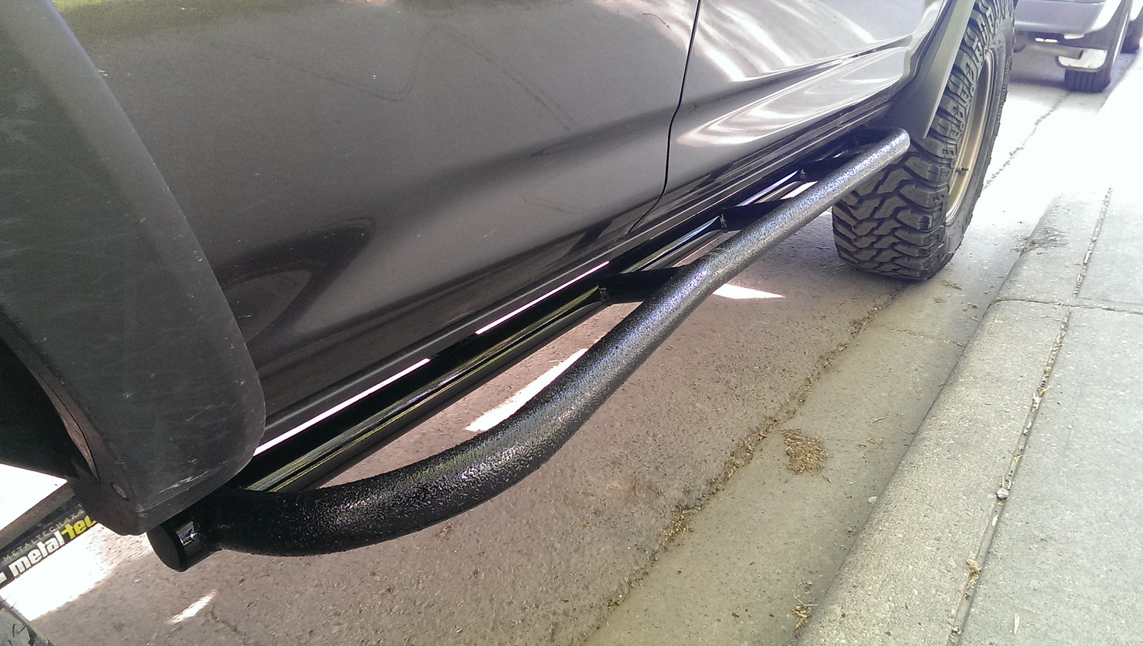

Has anyone successfully bed lined their sliders, either diy or professionally?
I have. Rustoleum professional bed liner in a spray can. Seems to resist chipping much better than paint and has withstood several months of daily use including the occasional gravel forest service road. Works remarkably well for a product picked up at wally world. CBI sliders.

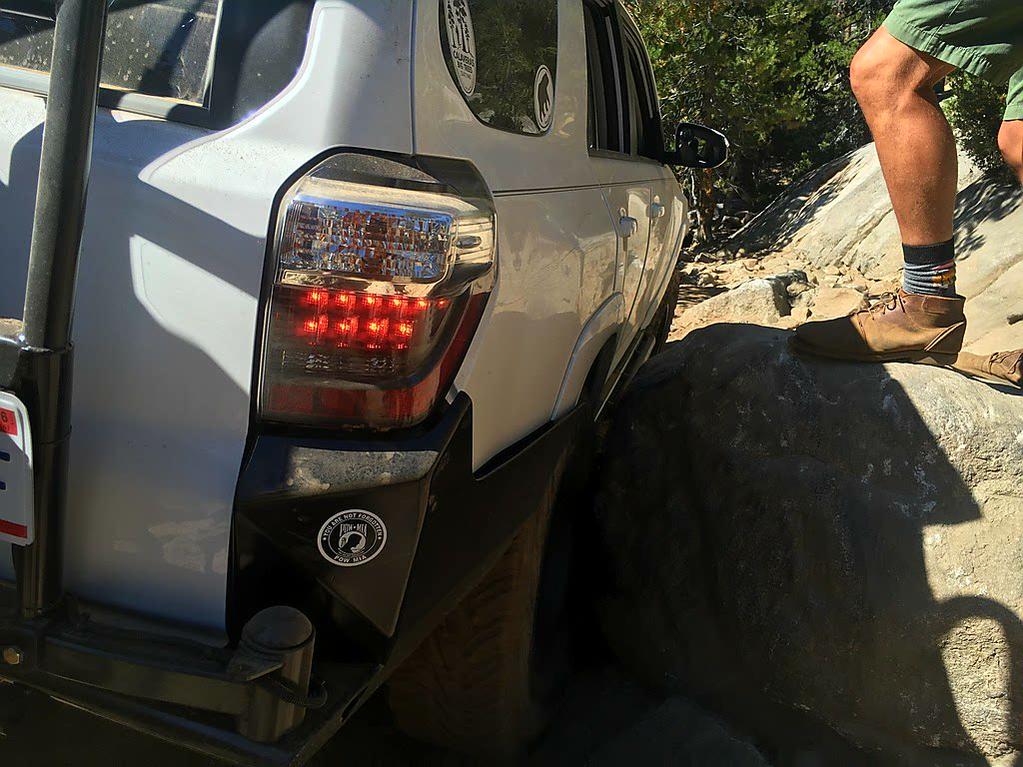

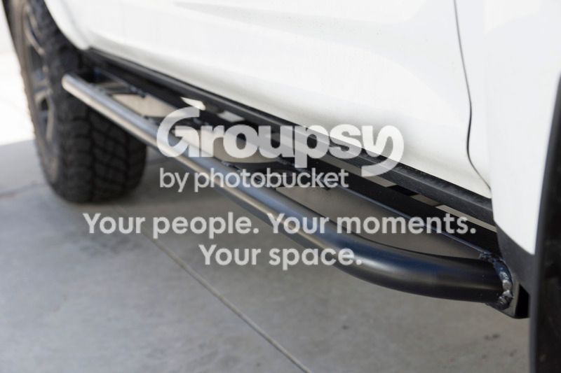

4x4 Labs - Fully plated to the frame rail - 3 U-bolts connect it to the frame
They're built like a tank, so don't let the price scare you. If you want ultimate protection, these are the way to go.
IMG_8916_zpsuuk0x1mg.jpg~original
I definitely second the 4X4Labs. Seriously stout and the "boat side" effect is a great feature. Plus the will take the use.

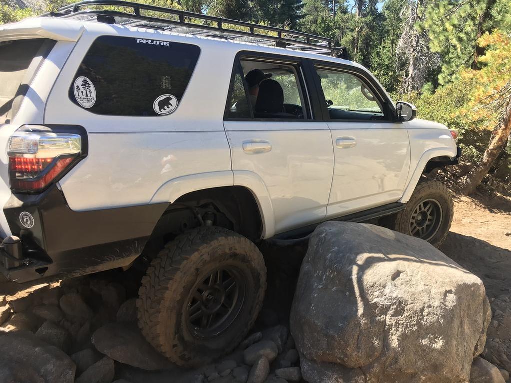

As far as I know 4xx4Labs are the only sliders that replace the lower trim panel, resulting in MUCH higher clearance. Still not sure how this hasn't been recognized as much on here. I had BudBuilt my last 5th gen and the quality was great, but the clearance advantage of 4x4Labs over them or any other slider I've seen simply does not compare. For maximum clearance 4x4Labs or full-custom is the only route.
Regardless, all your rigs look great!

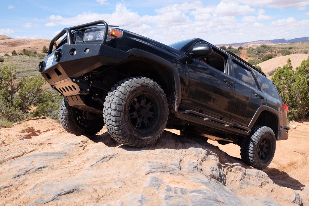

Custom HAF sliders, powder coated hammered black and touched up many times with rattle can bed liner

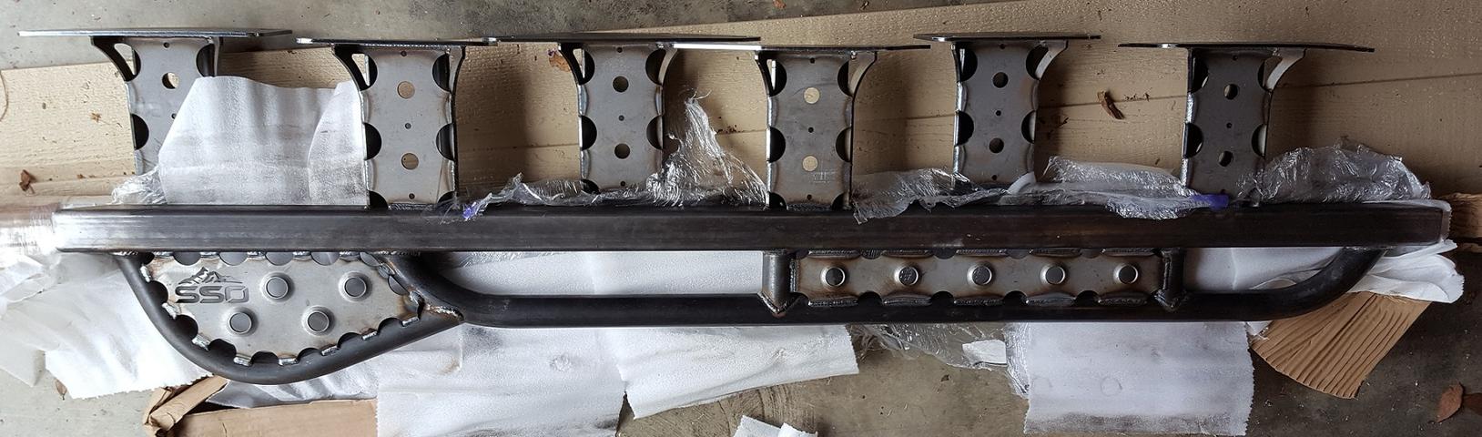

Yes, they use existing holes in the frame. I received them this past Friday and I'm attaching a photo. The sliders are stacked on top of each other, so it looks like it has 6 mounting locations, but it's 3 points per side. They seem really well made and I hope to get them cleaned and pained in the next couple of weeks. I got roped into coaching Soccer, so I'm now behind on all of my honey-do's and this will keep me from getting the sliders installed quickly :)
