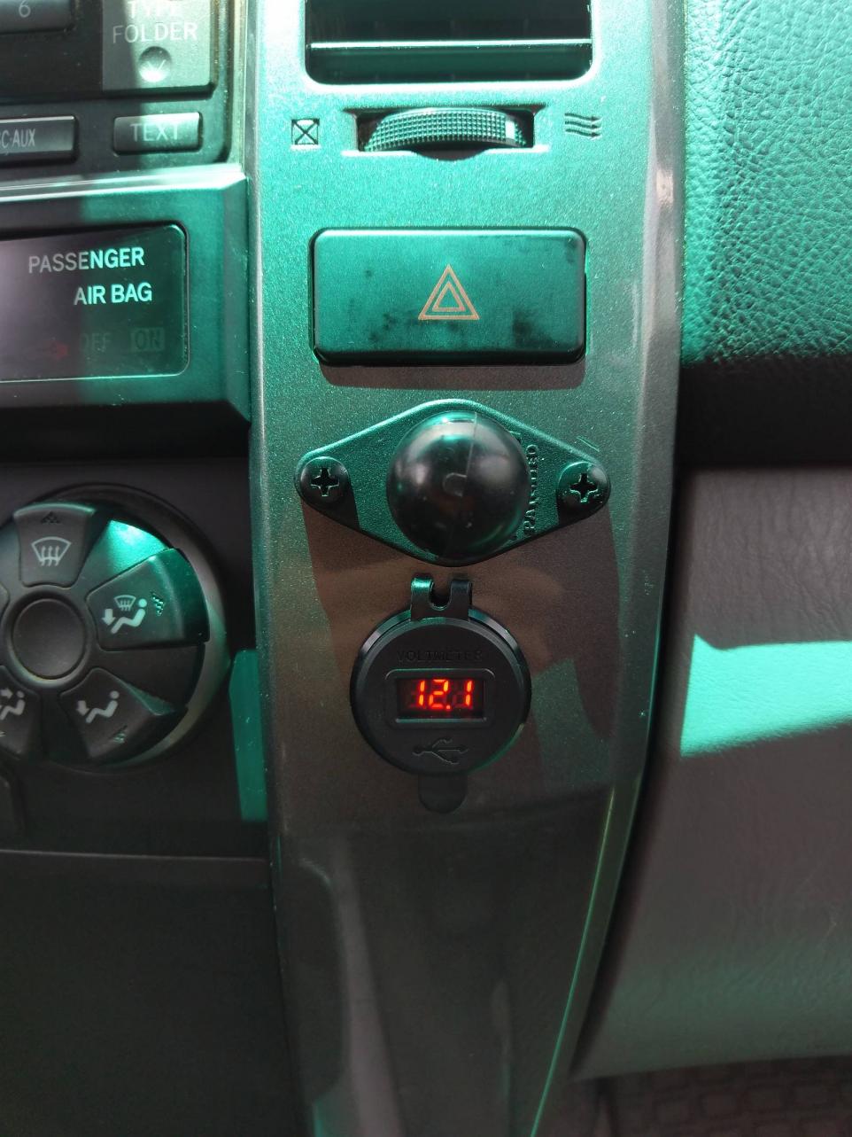

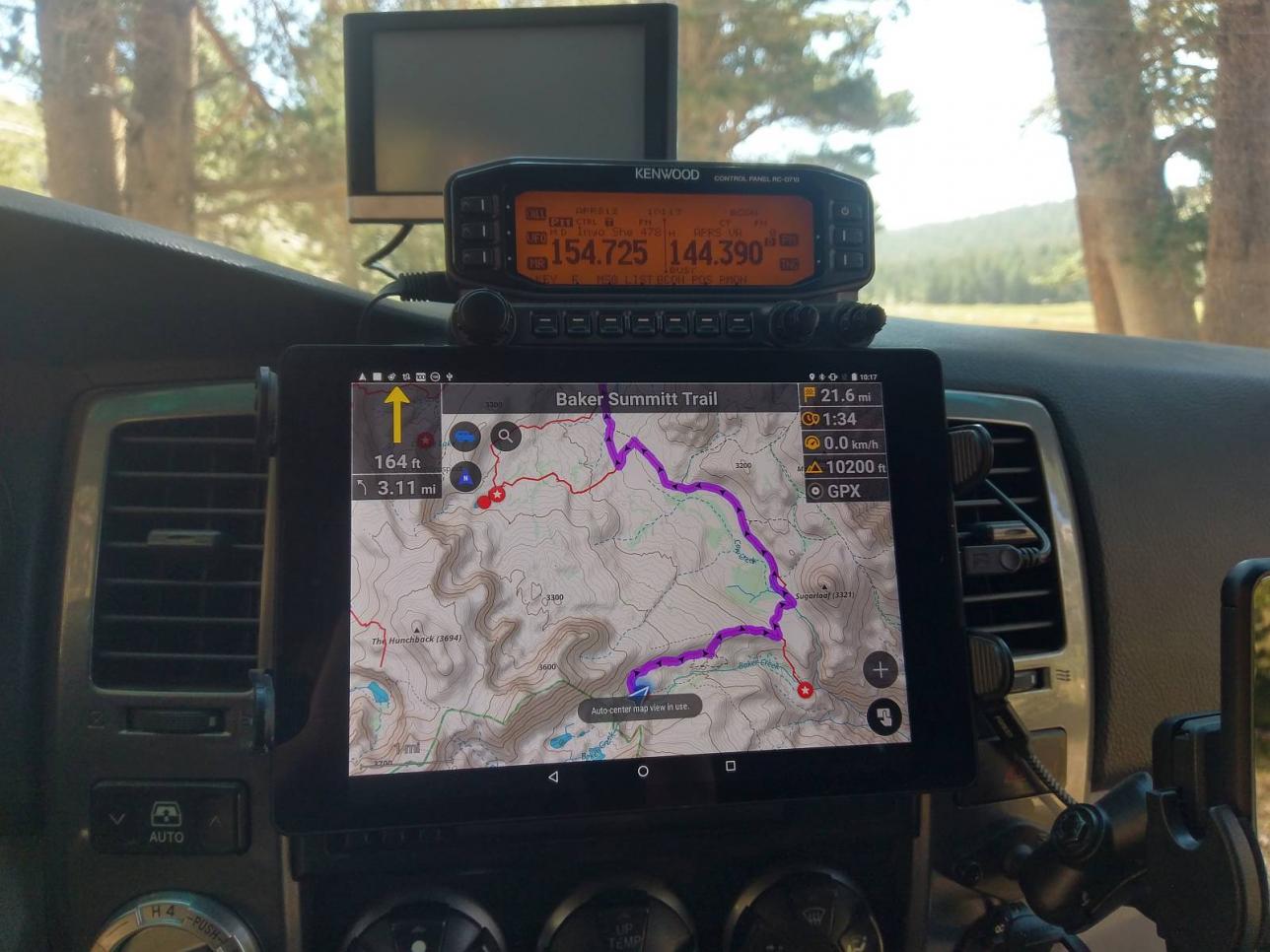

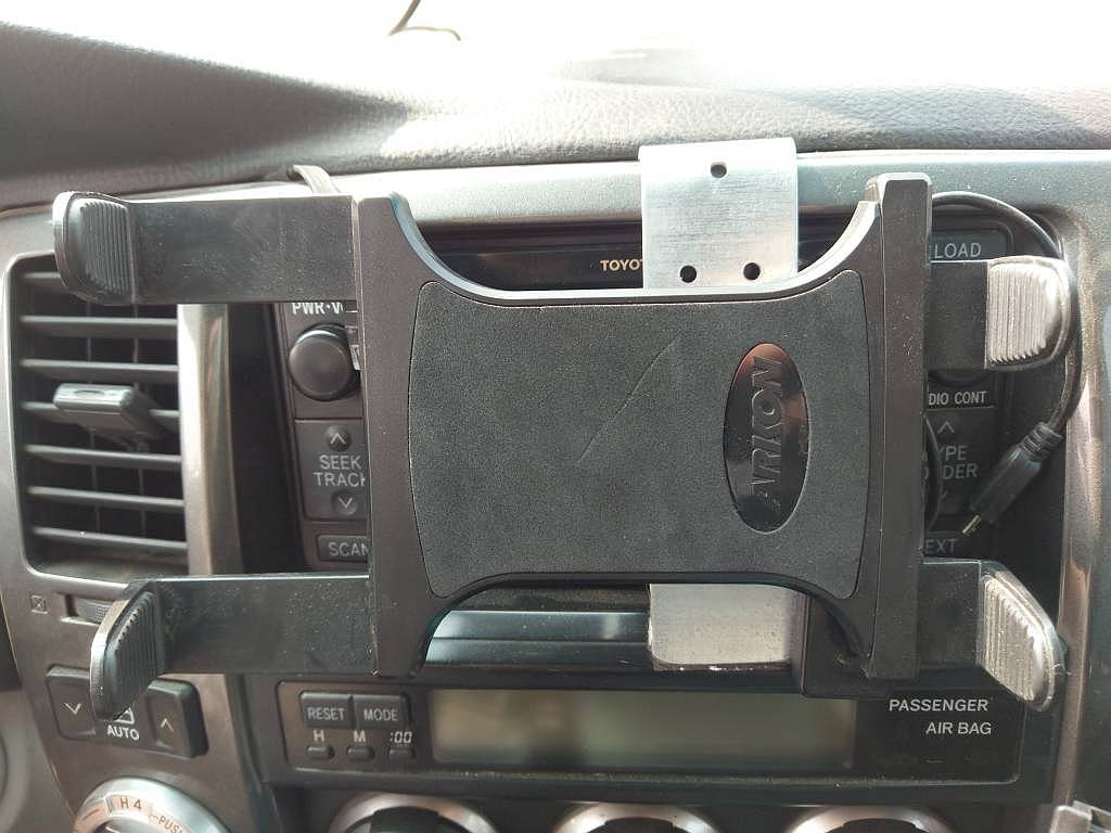

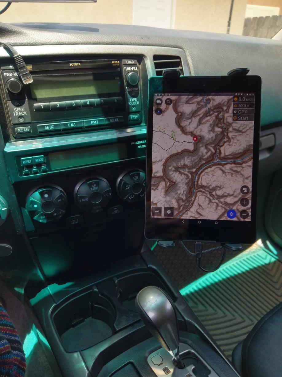

I got an Arkon mount and made a custom bracket to mount the tablet over the radio. This is a Nexus 9. It has been solid. Also added a RAM mount and USB port to the dash below the emergency blinker button so I can alternatively mount it there, but it like it better in the center.

I love your USB charger with voltmeter readout. How do you get that up there? How did you remove that trim? Thx.
You have to remove the HVAC controls, no need to remove they grey trim, you can drill the hole with it on. Follow the steps in this video starting at 4:30 and ending at 6:30. This lets you insert the charger and run the wires behind the dash to the fuse box.

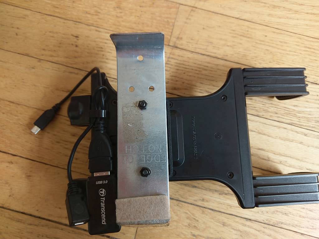

It's a piece of metal that I bent and that squeezes under the dash. The mount bolts on to it.

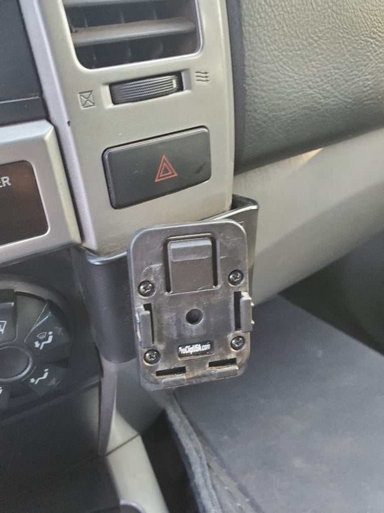

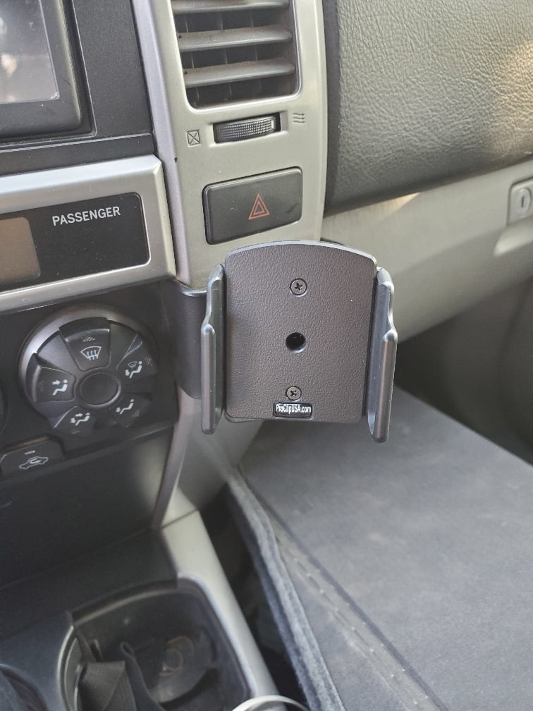

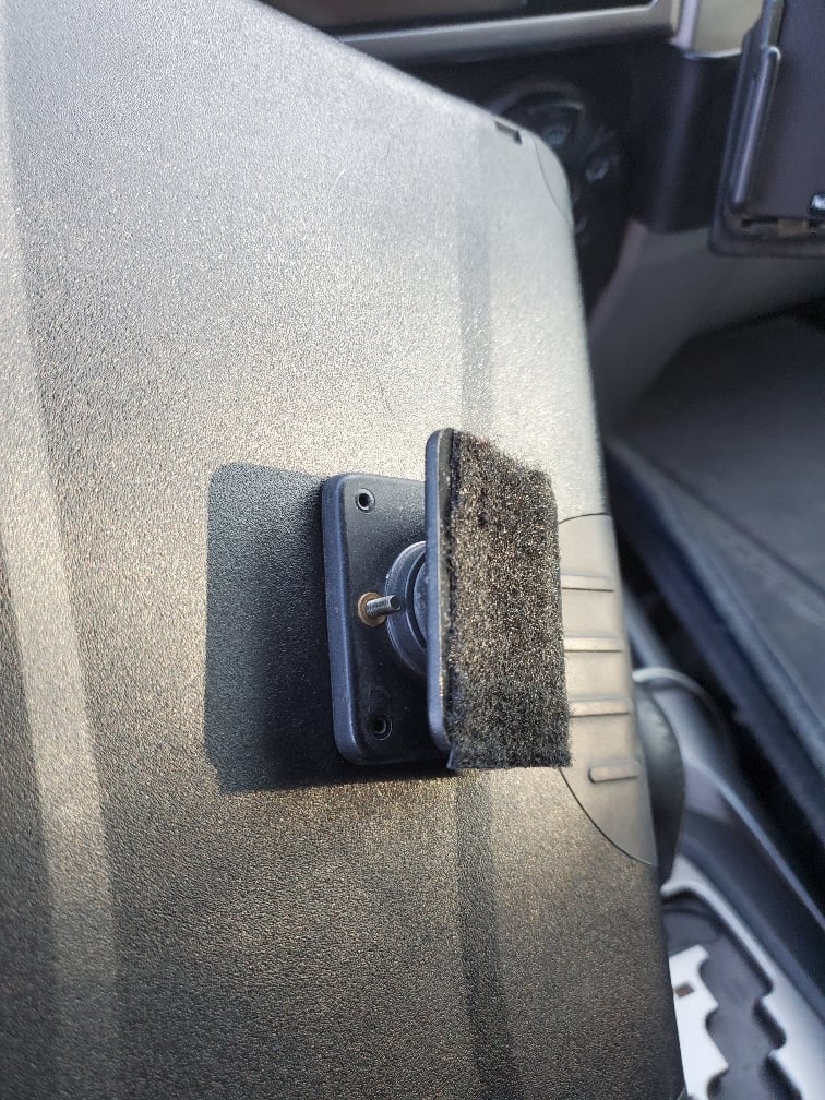

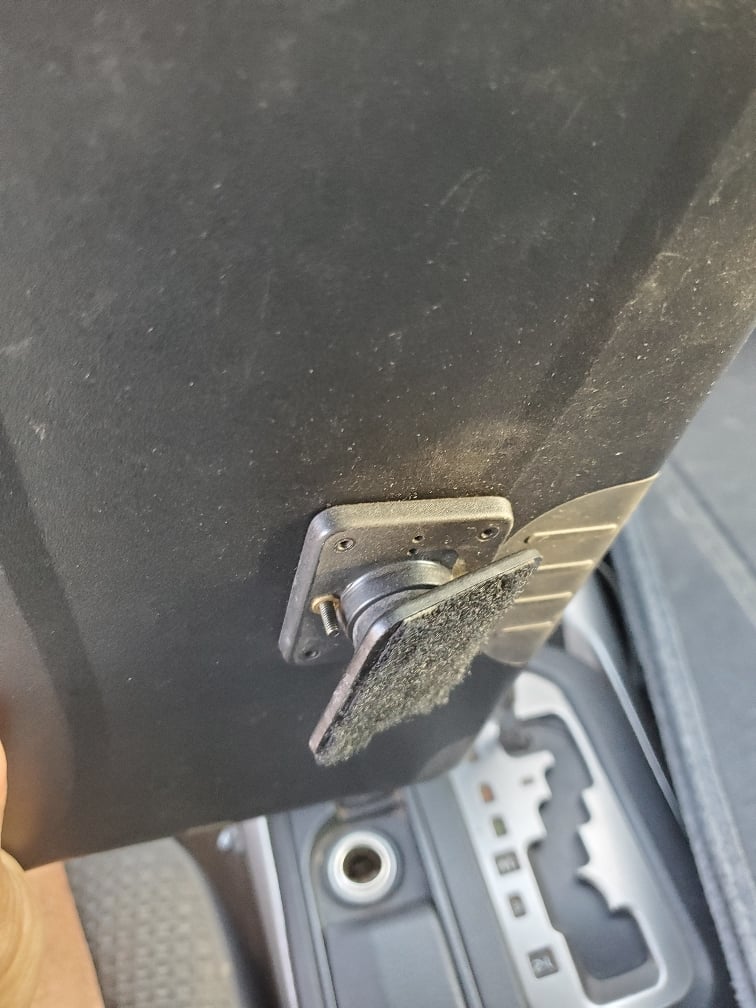

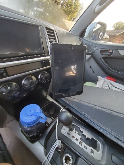

So I've been using ProClip mount for cell phones in all of my vehicles. Right after I posted this thread, I went ahead and took one of those cell phone mounts and converted it as a tablet mount. I'll be taking it on a trip this weekend so that will be the final test. Since my tablet already had a pretty decent hard cover, I simply drill two holes and use the screws that came with the mount and connect them as shown.
I temporarily displaced my phone from its normal resting place and will use a temporary phone holder that clips on to the air vent for these types of trips. The location of this tablet is perfect for me as it doesn't get in the way of accessing HVAC/stereo controls or the placement of the windshield sun shade or impede my vision.
This location does impede the access of the water bottle for the pass so I think we'll end up switching bottles. I'll grab the bottle in the pass side and vice versa.
Sent from my SM-G973U using Tapatalk
Oh nice, so it's just friction then holding it at the top? That's a good idea. How solid is it when off-road?
I has been very solid even on rough trails. The head for the radio is mounted the same way. The tablet shakes much more when mounted on the RAM mount.
