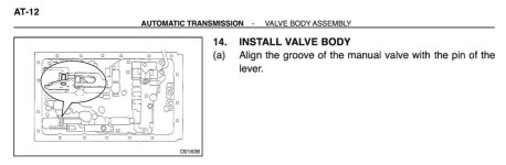

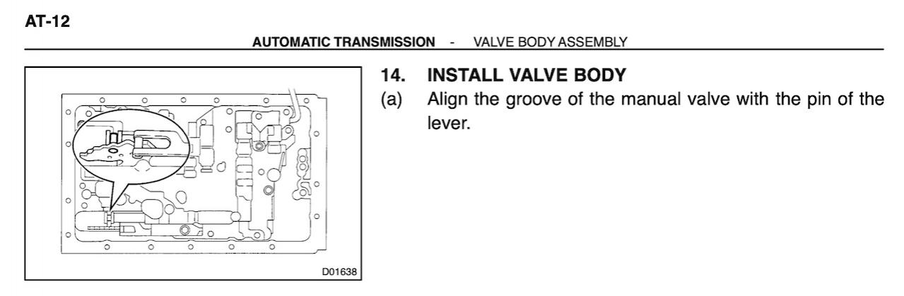

Other posts go over install and are pretty good, however be sure shift trans into N and to
line up the manual shift valve with the shift lever pin during valve body install,
see attached. Shifting the transmission into N makes lining the valve and pin up easier, but still can be done in P.

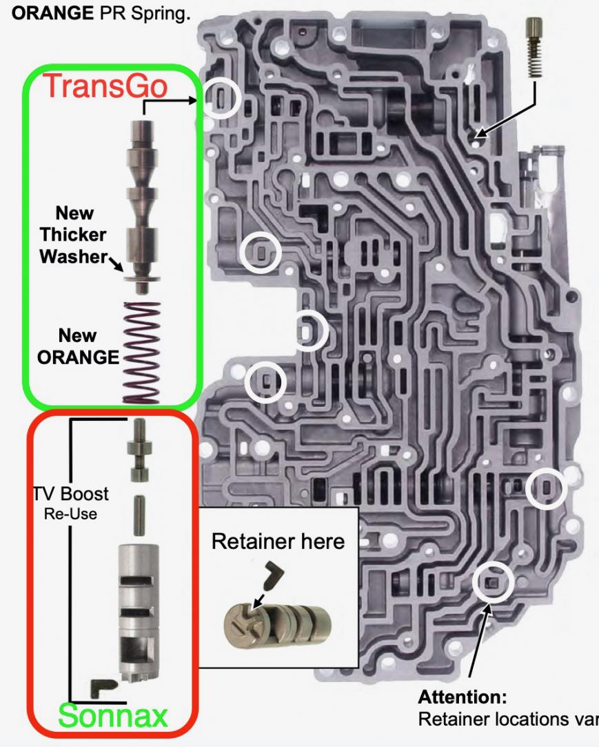

I combined the Sonnax boost valve and TransGo PR valve assemblies, see image attached.
The Sonnax o-ringed end plugs required a gentle tap with a brass drift to install.

I went with the SK 340 kit because I did not want the low hold feature (if I want to hold L I drop it to L), and the valve body plate holes can be drilled to match the HD2 kit if you want the quicker shifts.
I drilled my valve body plate to 1-2 0.062" (SK 0.055 / HD2 0.076 truck ), 2-3 0.062" (SK 0.055 / HD2 truck 0.062) and 3-4 0.055" (SK and HD2 0.055.)
After driving, I think 1-2 may have been better at 0.067" or 0.076" as in the HD2 kit truck drilling.
