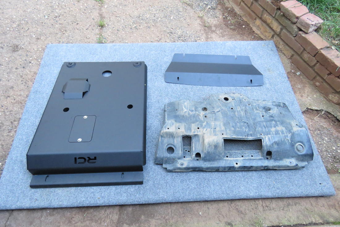

RCI seems like the only ones making plates that mate up to the factory TRD Pro front skid.

Before I went all RCI, my stock front skid had minor scratches but my stock fuel skid had several dents and looked alot worse. I think of all of them the fuel skid is the "low hanging fruit" so to speak. I'd go all aluminum unless you are playing in the rocks alot. Sliders first though if you don't have those, they will be better protection than skids for most of what folks do (both is ideal of course).

A little about what I run skid wise is below followed by my recommendation (I am sure many others disagree but it is my philosophy). I am currently running RCI skids front to rear. I did the front skid in steel as I know my approach angles could be better and on Arizona rocks I have taken some good hits. Then I did everything else aluminum. The only skid I forgot to get was the rear diff which will be on order soon. My reasoning for this, weight reduction while still heavily strengthening what I believe to be my weak points.
Note: I went with RCI because of the Group Buy I jumped on. My only frustration with the RCI steel front skid is the lack of drainage (I may replace this skid at some point) beyond that they took some damn good hits in colorado on Poughkipsie Gulch including a high center and took minimal damage.
