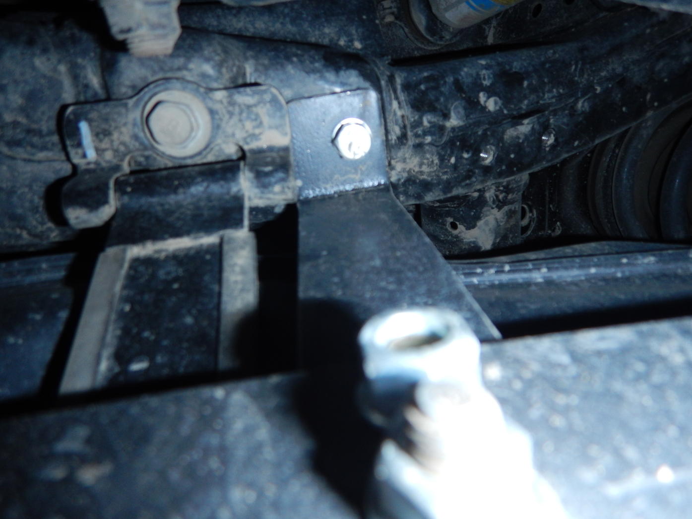

First picture shows the very stout support on the driver's side front of the gas tank skid.
From the back of the flange behind the second bolt (the one on the right) is 38" unsupported to the back of the gas tank skid.

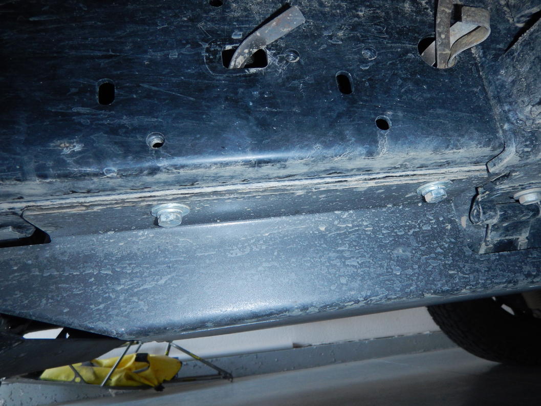

Second picture is my added support. It uses the two holes present in the skid and the existing threaded hole in the frame where the factory skid bolted in. Yes, the whimpy factory skid was bolted at all four corners.

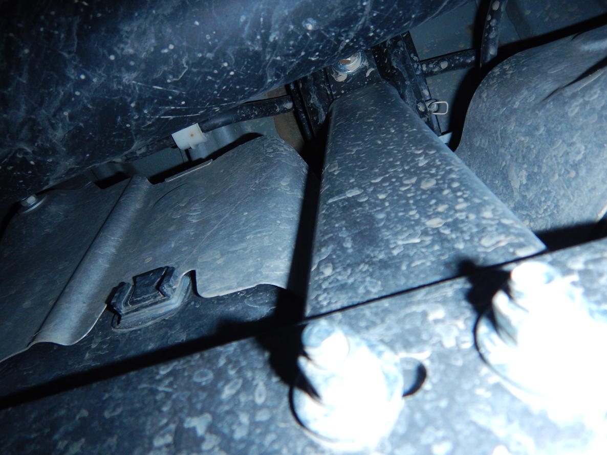

Third picture shows the support for the passenger side front of the gas tank skid. I wanted something this beefy but my shop wouldn't let me into the fab area to discuss the mod so I go what is in the second which is basically bent heavy duty strap metal, much better than nothing, but not what I hoped for.
