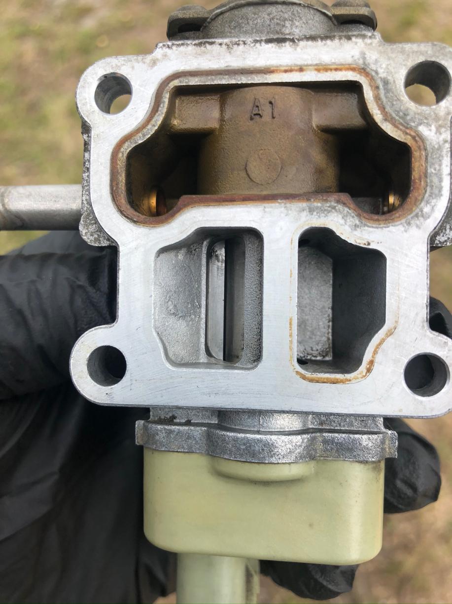

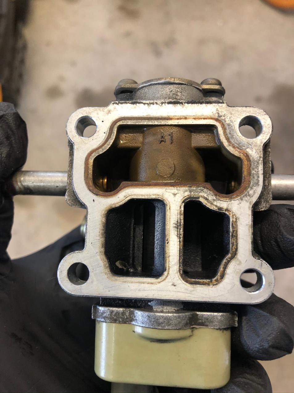

Your iac doesn't look that bad to begin with. Mines were way worse with carbon. Since you have is off might as well check ohms if you have a meter.
Between center and right and then, center and left should be in the 17-25 ohm range to pass.
Tested 21

That IAC really got clean. I suspect that is the problem but will be curious if that sound comes back.

So after cleaning the IAC and reinstalling everything it now stall even worse. Doesn't surprise me but here is another video. It now will only run for a min and stall.
This now happens everytime I start it up.
