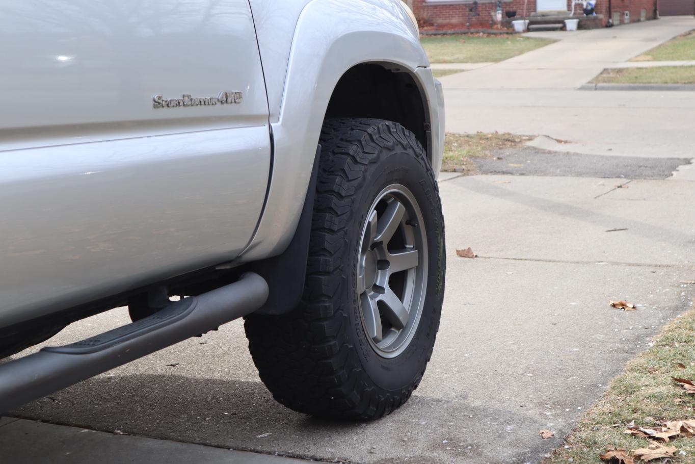

I'm running 0 offset on mine which I like. -10 will be a little aggressive but necessary if you plan on running bigger than 285.
