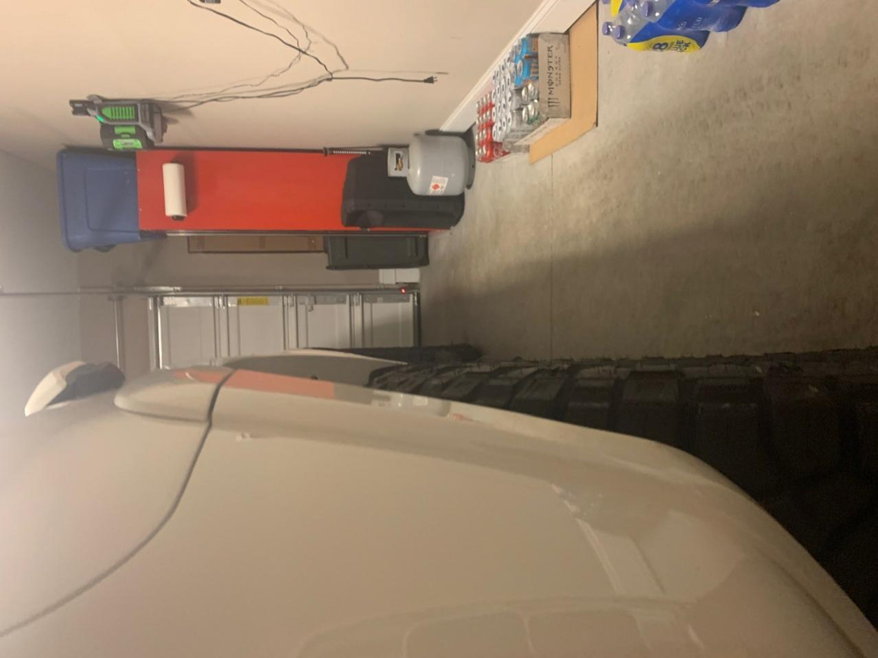

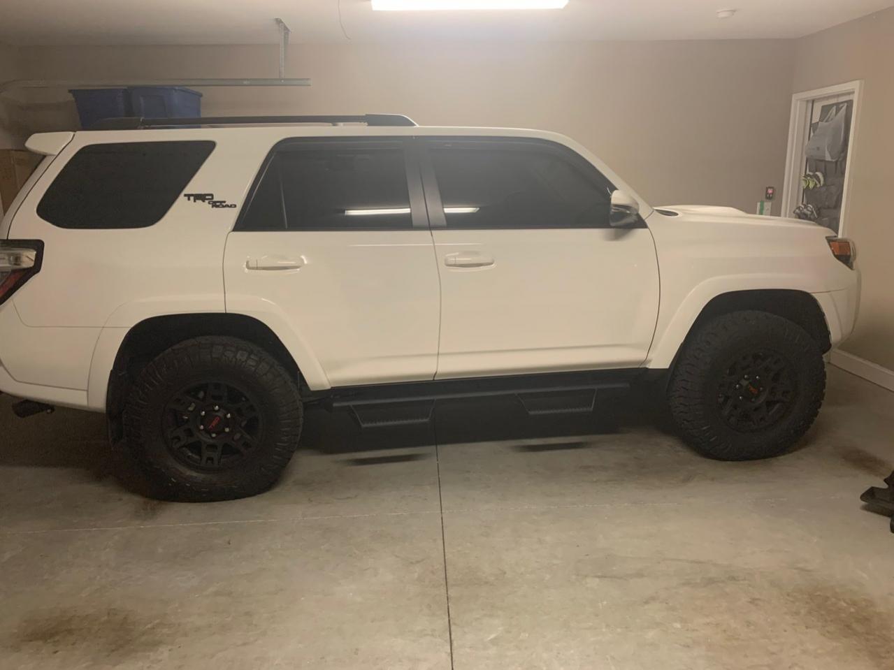

2019 trd orp
Bilstein 5100s at 1.75 setting up front stock coils.
Bilstein 5100s out back w/ stock suspension.
Went w/ Nitto Ridge Grappler 285 70/17 Cs. TRD Pro wheels. No wheel spacers.
Measurements before In inches:
Front Passenger 34 5/8
Rear passenger 36 7/8
Front driver 34 1/2
Rear driver 36 1/2
Measurements after in inches:
Front passenger 37 5/8
Rear passenger 37 7/8
Front driver 37 1/8
Rear driver 37 3/8
Installed at Rock your 4x4 in Knoxville, TN. Very knowledgeable/experienced shop. Had to trim a little off the front and push the fender liner but no rubbing.
