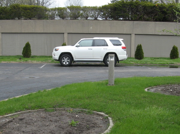

I'm afraid you're going to get differing opinions on .85 and 1.75. Here's mine set on .85. I never took any measurements.
Don't forget you should reaim your headlights.
