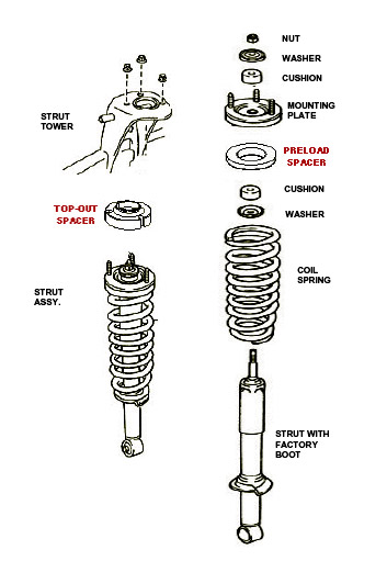

This might help you visualize it better:

With XREAS, from what I hear the spring compressor is necessary no matter what cause of the lines for the shocks (correct me if I'm wrong there).
I think where your'e confused is the type of spacer. There's a type that goes above the strut assemly, the top out spacer (what I used or the EZlift shown on the left side above in the illustration) and on that goes into the spring in the assembly (shown on the right side in the illustration above). The ones like I used above the assebly require no removal of the spring. The 3 bolts up top mount to the spacer, which mounts to the strut tower. The EZ lift has "extenders" that extend the strut bolts through the other side of the spacer. With one of these systems, you do not have to compress the spring, just pull the whole assembly out, bolt the spacer on top and bolt it all back in.
Docs instructions are for pulling the spring assembly apart like you would for XREAS or a coil spacer that goes in the spring assembly.
I haven't put spacers in my T4R yet so I could be wrong on this, but I have been reading a lot of different threads on the subject. From what I have read, for installing top-out spacers, particularly the smaller 1/2" ones, you can get by without spring compressors. But someone please correct me if I am wrong on this.
Thanks. I've read that thread, but it includes changing out the springs, which personally I won't be doing. All I will be doing is installing 1/2" spacers in the front, probably Toytec. So for myself, what I am looking for is a thread with instructions, and with pics if possible, just for installing front spacers, if there is such a thread.
FYI.. If you are using the Toytec 1/2" spacer, you will have to dis-assemble the front strut assembly anyways since you have to install longer studs into the upper shock mounts.
go with the one I did or the EZlift spcers and you'll be fine and not have to disassemble the strut assembly. They're much easier.
The spring compressor is needed because the spring has to be compressed, which really has nothing to do with XREAS. Webby says he'll be installing a 1/2" spacer, which is a preload spacer, just like the one I installed. There is no way possible to install such a spacer without a spring compressor unless you are Superman and can compress the coil spring with your hand!
The small 1/2" spacers are pre-load, not top-out. Where did you see top-out spacers that are only 1/2"? Or are you confusing the two? Most kits come with a small preload (usually 1/2") and a larger top-out spacer that are designed to work together. If you're just looking for 1" of front lift, you can just do the 1/2" pre-load spacer by itself.
Thanks. I googled EZ-Lift Spacers, and this is what I found: Ez-Lift Unless there is a different source for the EZ-Lift spacers that has more options, I see a couple of problems with these for my application:
1) they show the products for 2003-2007 T4R's, and my runner is a 2009;
2) the least lift they show are 2" Lift Spacers (which I presume is 1" of material), but I am looking for a 1/2" spacer for just 1" of lift.
Are there any 1/2" spacers available that don't require disassembling the strut assembly for ease of installation, and preferably don't cost as much as the EZ-Lift spacers -- those are priced at $130, while Toytec 1/2" spacers are $60 (yes, I understand I'm not quite comparing apples to apples, since the EZ-Lift spacers are thicker).
Bottom line for me, ease of assembly is definitely a factor, but so is the price of the spacers.
I've read so many threads here on this subject, and also info elsewhere, sorry, I just don't recall where I might have read about 1/2" top-out spacers. Correct, I am just looking for 1" of front end lift. So are you saying that there is no such thing available as a 1/2" top-out spacer for 4Runners?
If there is, I've never seen it. All of the 1/2" spacers I know of are pre-loads. You're better off with a pre-load spacer anyway. I've had mine for a few years now and there was no difference at all in the way the vehicle rides or handles. It's completely transparent.
BTW, anything you see advertised for 2003-2007 will also fit the 2008 and 2009 4Runner. They are all the same.
Toytec has a 1/2" top-out spacer and comes with longer studs. It's listed as providing 3/4" of lift, but it's 1/2" thick and yields 1" of lift. This would not be considered an EZ spacer because you have to R & R the top studs, but it is "top-out".
