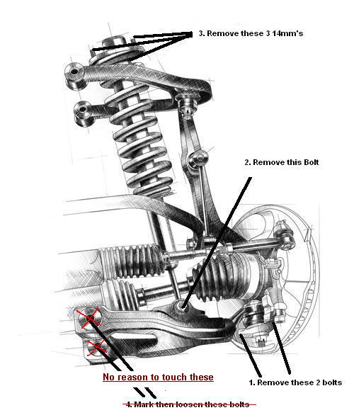

There is no reason to loosen the bolts on the lower control arm. I'm not sure why anyone would even think that needs to be done.
The 2 bolts by the wheel or the eccentric bolts to adjust alignment?
Either way I did my daystar lift this way, the second time around. Its so much easier/faster, that its a no brainer in my opinion. The first time I removed a bunch of extra stuff, used the factory jack to push the A arm down (wedged against the top inner wheel well), etc. It was a lot more trouble and took twice as long.
I was talking about the eccentrics that adjust the alignment--there's no reason at all to loosen them to install spacers. I think it's bad advice to post a write-up when something unnecessary like that is included
When you can't take a 3ft. Prybar and pry the lower A arm down or even stand on it and have it swing down out of the way, you need to loosen the bolts. If you can get away with not loosening them, do it! You're really lucky! YOU WILL NEED AN ALIGNMENT ANYWAYS! I think it's bad advice to tell people to cut corners and to not touch the bolts and spend over an hour trying to pry the lower A arm out of the way when they can mark a bolt and get the alignment close to where it was instead of taking the minute to make it easy to swing the lower A arm. The truck should not be driven far till you get an anilgment. It'll be about +1.5 degrees camber (yeah, that's huge when it should be -.4).
What I found was when I loosened them, the eccentric didn't even turn out of alignment. Maybe I'm lucky on that. The alignment was still way cambered in by the way. I fixed my illustration.

Two points:
1- you don't need to pry anything with a prybar. You can use the bottle jack that came with your 4Runner on the control arm. Try it next time, it works perfectly.
2- I installed a small leveling spacer on my own 4Runner. When I put it on the alignment rack, it was still within factory specs. So I did not need to adjust the alignment at all, but I did put it on the rack to check it.
A couple of questions if I could trouble you, as I am about to add 1/2" spacers to my T4R:
1) Which is the control arm?
2) Step #1 in the Diagram, are the two pointers referring to the large bolts to the right of each of the two pointers?
Thanks very much!
Thanks very much!
You have two control arms (upper and lower), which are also sometimes called A-arms:
Thanks very much!
For step one it'll be obvious when you look. BY the balljoint there's 2 bolts on the bottom of the piece of metal The head is on the bottom and they're vertical bolts. Just pull those two
