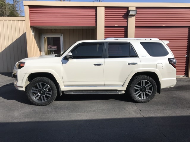

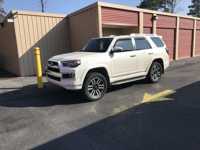

Took a few pics. Wasn’t on completely level ground. Feels like it slopes to the rear a lot more than it looks. I measured from ground to crown of wheel well, and the front is 1” taller than back at same measuring point.

Yea take it back and tell them to either do a 1.5 rear spacer or to take the front down an inch.
Here is mine..
Just put a spacer on the rear coil. Much easier than dealing with the front again. A 1 inch space on the rear will look good. Did you use a spacer lift in the front?
