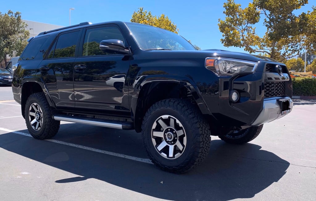

Here's mine with the Cornfed 1" in front and loaded the way I usually travel for work - about 100-150 lbs in the rear. Bring the wife and a kid or 2 on a trip and their gear and it sits completely flat real quick, almost to the point of being low in the rear. It's a good place to be. Glad I didn't go higher in front unless I was messing with the back too.

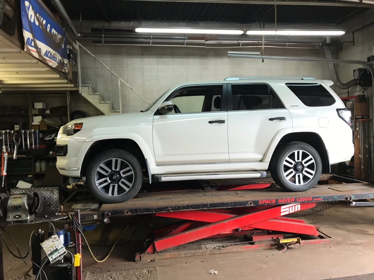

I used a cornfed 1" spacer lift up front on our '15 Ltd., drives more like a truck with the chin up a bit from stock, still has a bit of rake so the rear isn't lower when fully loaded, install was a breeze, do get an alignment after though.

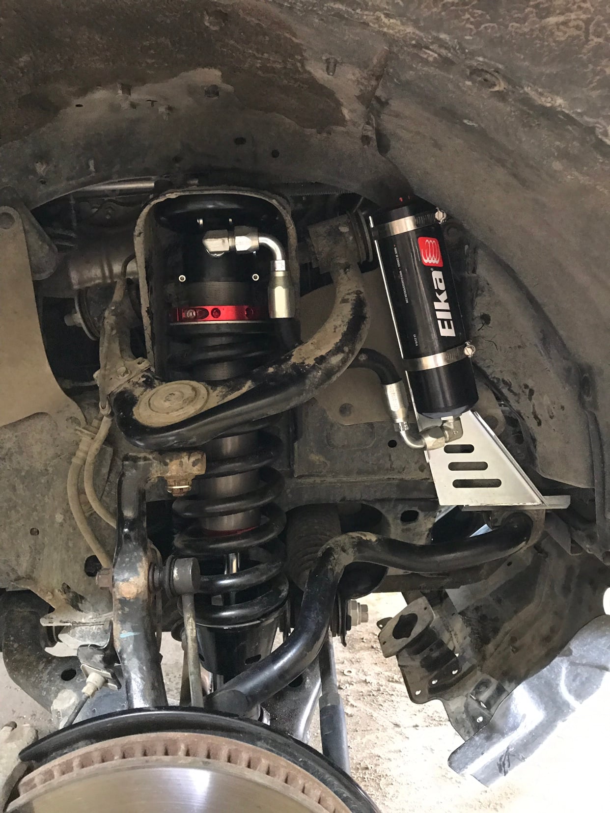

I went with a full suspension kit since I didn’t like the idea of using spacers and it’s sitting perfectly levelled now.
You can’t go wrong with the Eibach kit. It looks so good and rides even better. Personally, I wouldn’t go with spacers.
