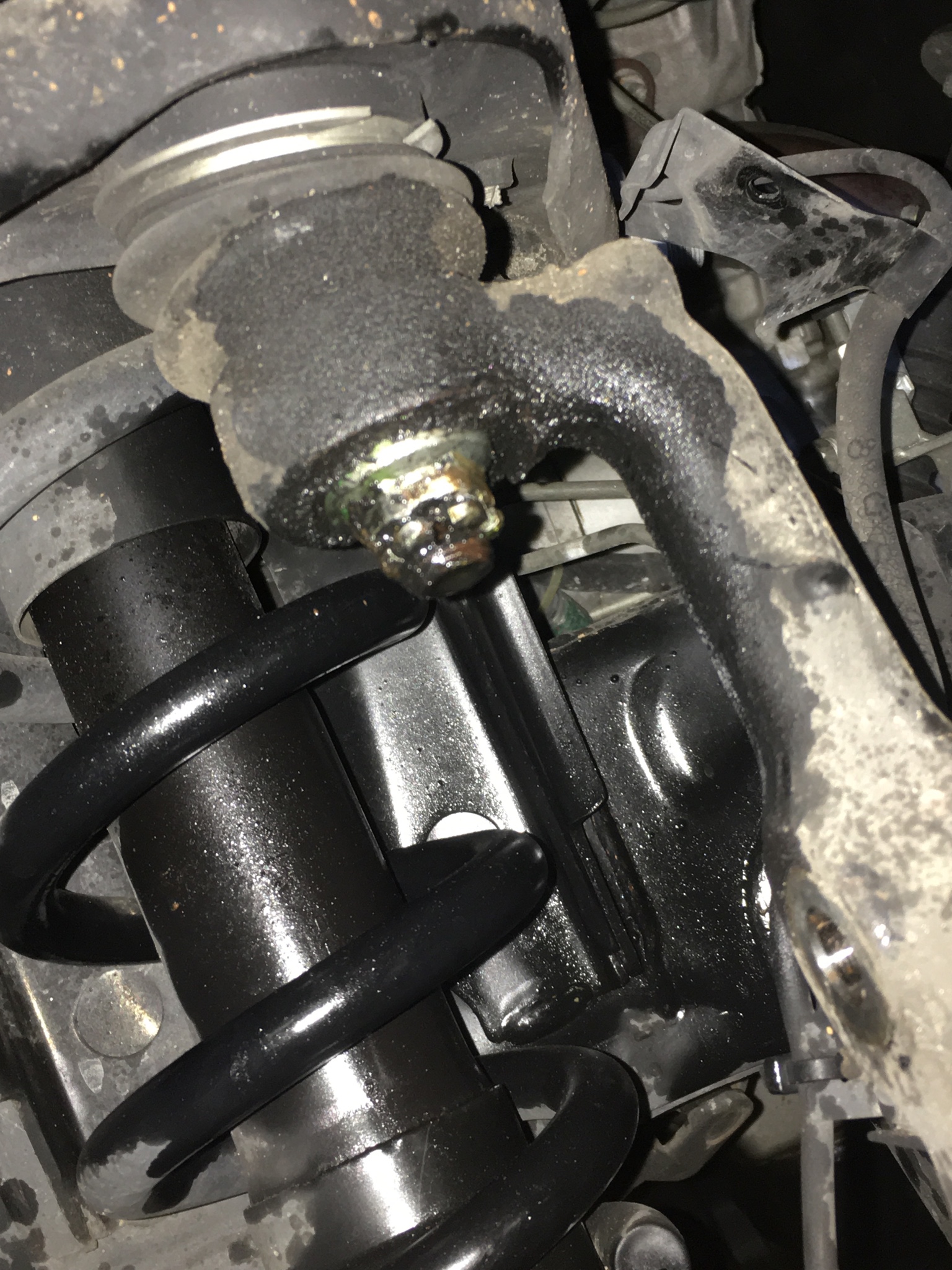

A few weeks back I was working on installing my daystar leveling kit when I ran into a snag. My drivers side upper ball joint nut is stripped. The bolt is holding firm however the nut seems to be rounded off. This is the one with a cotter pin right below it (yes I took the cotter pin off first). I can't find this nut online however my local dealer claims to know what part I need and can order it for $5, however that was only after an hour of arguing that I don't need a full new upper control arm.

Can you add pictures so we can get an idea of what shape it's in?

Not the best picture however all I have for the time being.
Are you using hand tools or impact gun. I had to use an impact gun on mine I was having the same issue. Trust me if you can get a socket on it and get the gun on it that will work. Also have someone hit as your taking it off.
Just looking at the photo it doesn't look that rounded to me, have you been using a 12 point wrench/socket or a 6 point,
if you been using a 12 point try with a 6 point,
it looks like it could be removed with a 6 point, but I'm not there looking at the nut.
If you only have 12 point sockets I would highly recommend you purchase a good set of 6 point sockets, they come in handy with rusted bolts and nuts!!
If a 6 point socket doesn't get it off and starts slipping I would use a good pair of heavy duty vise-grips locked down as tight as you can get them.

I think some parts stores sell a set of sockets by Irwin that are made to grab onto rounded nuts, you can also heat it and try to hammer a slightly smaller socket onto it and use that

I've been using hand tools as that is all I have access too. I will look into a set of 6 point sockets and see what I can do.

I am up in Clemson. I've been using 12 point as that's all I have access too but I'll look into some 6 point and see if that helps.

If you can get an impact gun on it that should do the trick. Hope it works out for you. Keep us posted.
