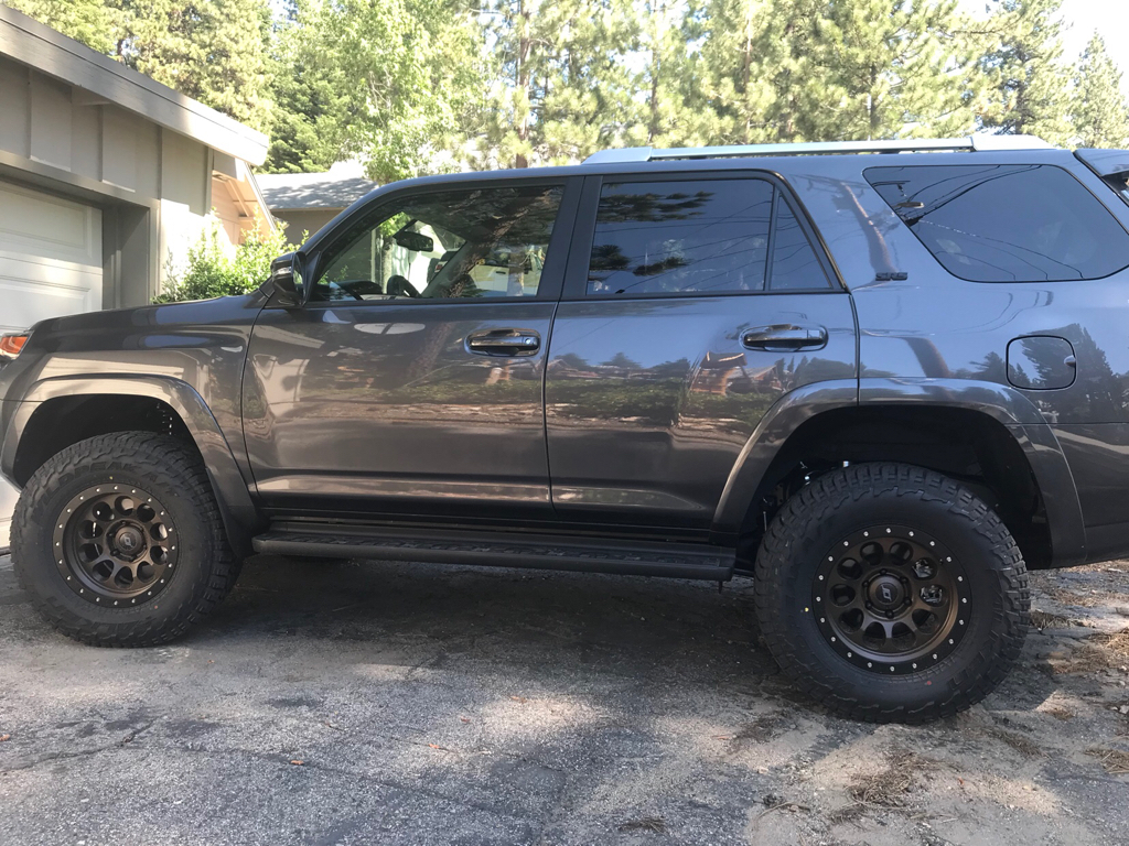

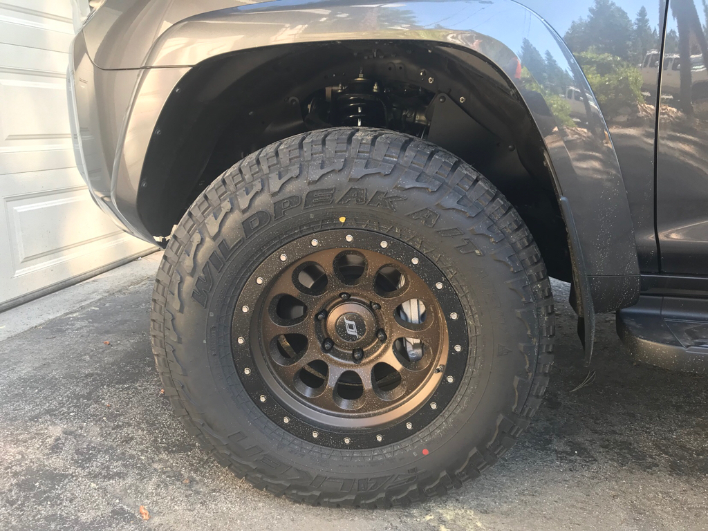

The 6112/5160 combo from Bilstein is rock solid I added 2” icon rear springs and it rides better than stock with 2.5 upfront and 2” rear. Riding on 285 70/17 wildpeaks.
Front clearance a little trimming

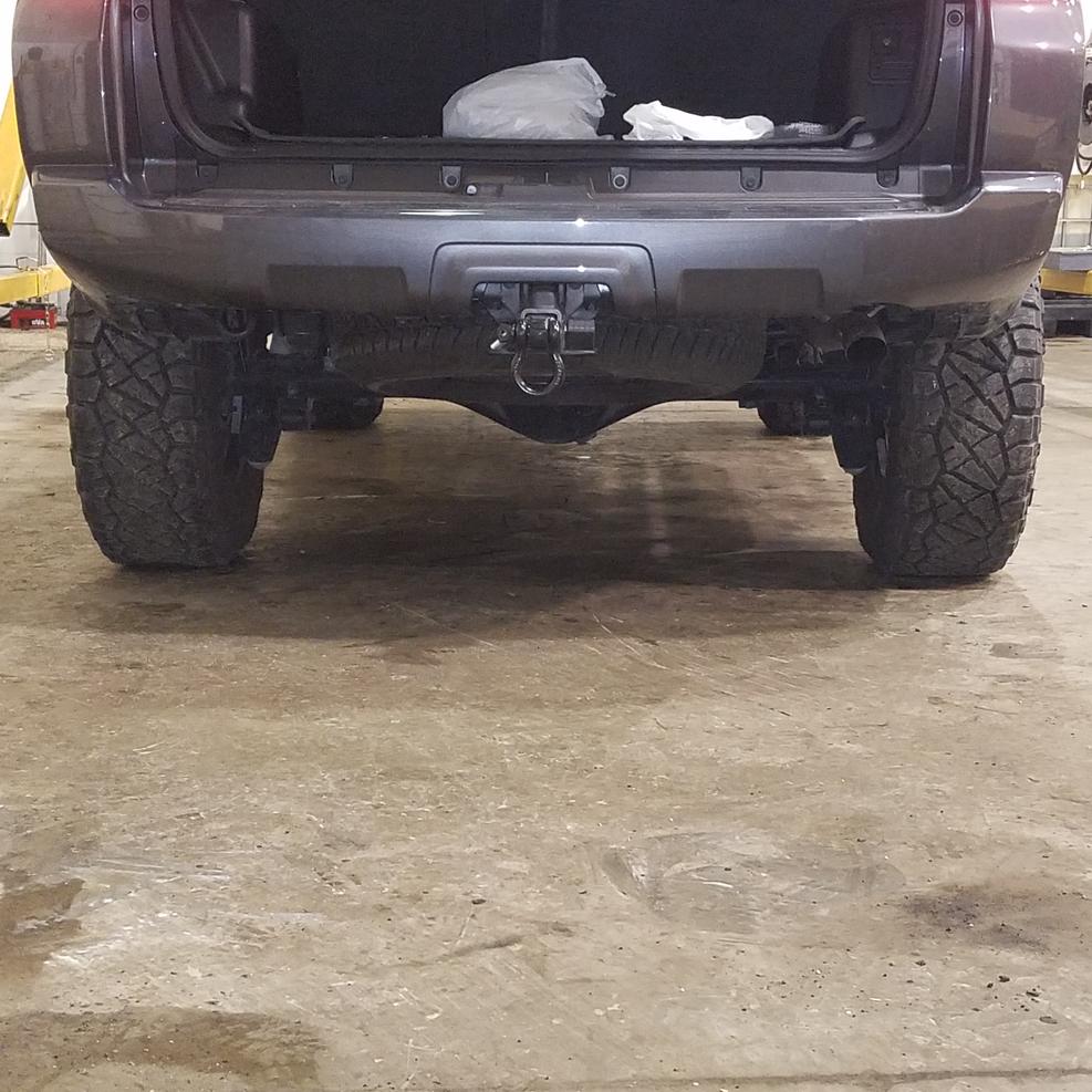

ToyTec Ultimate kit. 3" front, 2.75 rear. 295/70/17 Ridge Grapplers on a 17x8 wheel with 4.5" BS and 0 offset. No body mount chop, slight fender liner rubbing which you're going to have either way, great results. Move the front inner fender liner forward, trim the inner lip of the bumper that you'll never see anyway, good to go.

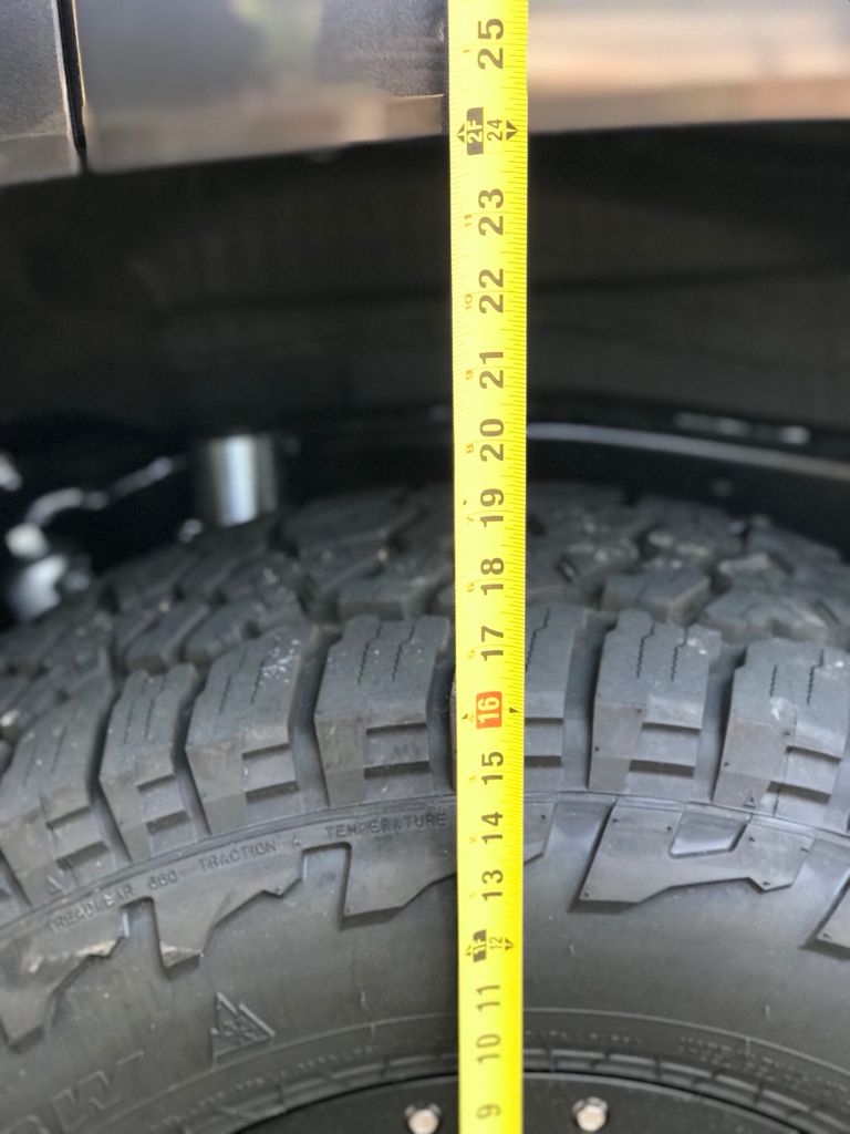

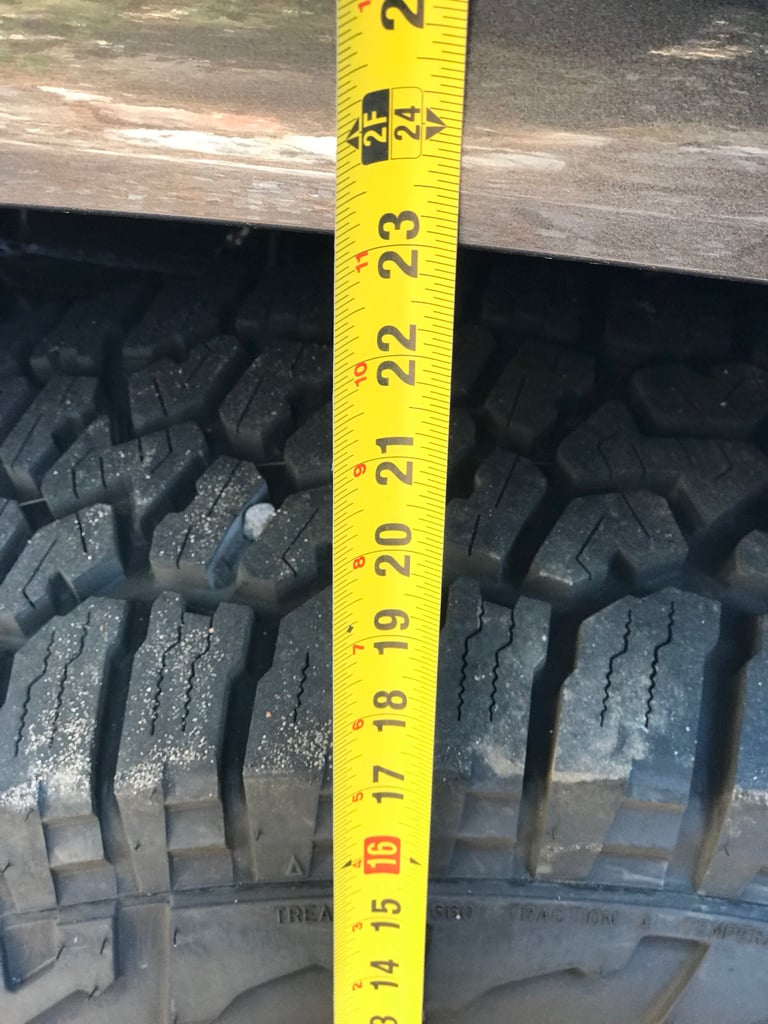

How far from center hub to fender in the front and rear? My 6112/5160 combo with Icon rear springs is as follows:
Front 23” center hub to fender
Rear 25” center hub to fender it looks like 24 but my hand was shaking while taking the pic.
Front is 23 which puts it dead at 3" over stock. Rear, not sure don't remember. I used the 2" ToyTec spring with a 3/4" spacer added to the the DS and 5/8 spacer on the PS to level it out side to side.

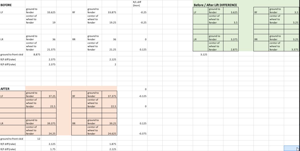

I had local shop install Toytec Boss 650# front / HD rear springs and Total Chaos UCAs. Have over 2k miles on it now. Loving it. These measurements were taken to the nearest 1/8" by me. B/f and after pics in album linked in my sig.
