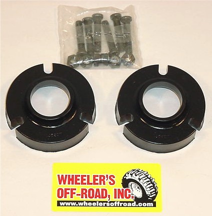

How about these......
Daystar front coil spacer 1.25" from Wheelers
http://www.wheelersoffroad.com/kt09105.jpg
They say 1.25" but I have to assume that is the size of the spacer and not the amount of lift obtained from them.

The 885 springs will put the truck over level. They will also increase the spring rate more than a spacer. The Daystar spacer in the above pic is around 3/4" and will not change the spring rate. There is also a Daystar preload spacer that is about a 1/2" thick and will firm the ride slightly. Both spacers will give about 1.25" of lift. If you want to lose some body role and brake dive then use a preload spacer. If you think the ride is just right use the top spacer. The Daystar spacers are only $59 and alot of dealers use them to just level vehicles.

Keep in mind that the amount of lift will be double that of the spacer. So if your spacer is 1 inch thick, you'll end up with 2 inches of lift. How thick are the Daystar spacers? Did you actually install them yet?

the daystar spacers are between 1 and 1.25 inches (probably really like 1 1/8 in, at least mine were) and they give you exactly 2 inch of lift. I think this looks good, it is not nose high, the rear is still .5 inches higher.
