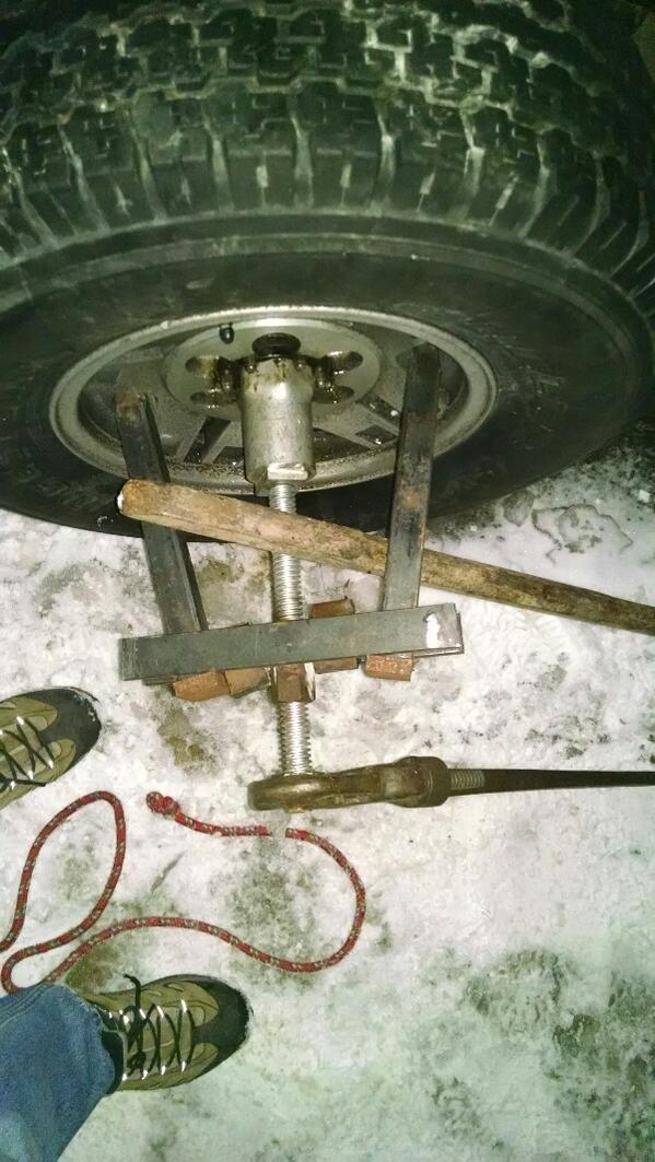

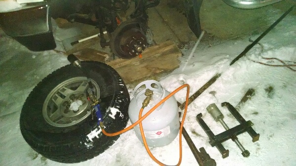

And I'm trying this again once I re-weld part of the custom puller arm...
Here's the winning combination. If I heated the wheel, I could get a turn or two on the puller. Everything worked pretty well once I re-welded my broken welds. It took all 210# of leanness standing on a pipe wrench to budge this thing.

The thought of having to sit on my butt in the snow made this option far more attractive. The best thing is that what was once a failed home made puller project from a couple years ago now gets to save the day. "See Honey, there is a reason I keep all that junk in the garage"

what was keeping this bad boy stuck ?
Aluminum wheels and iron hubs don't really form strong chemical bonds.
Was was the interference ?
I for one and impressed by the artfulness of the puller, but still wondering WTF was the root problem ?
Aluminum Oxide wedgie.
There was quite a bit of it in a pretty close tolerance space.
The PB blaster hardly got into it.
