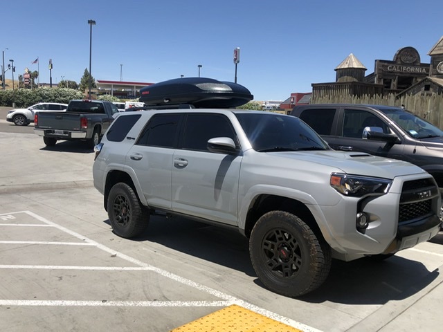

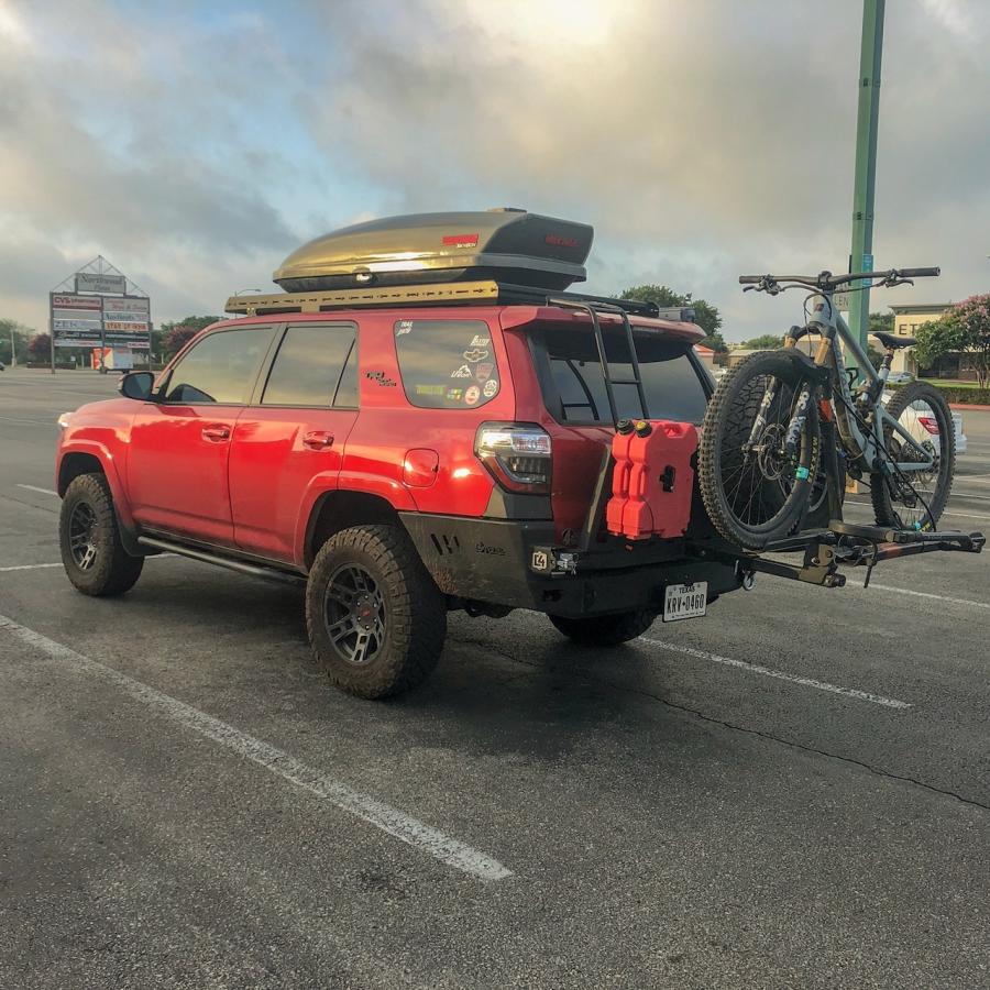

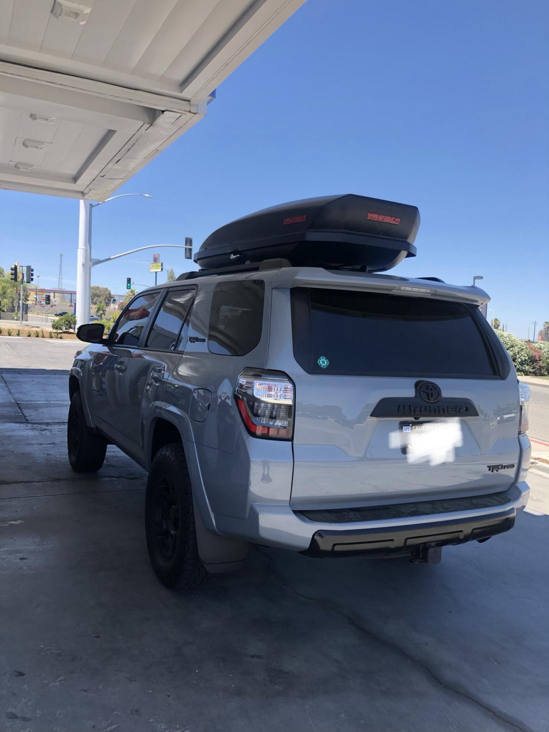

LFD bars and Yakima skybox. Love how low the box fits with the bars. A few big road trips in and love this setup
