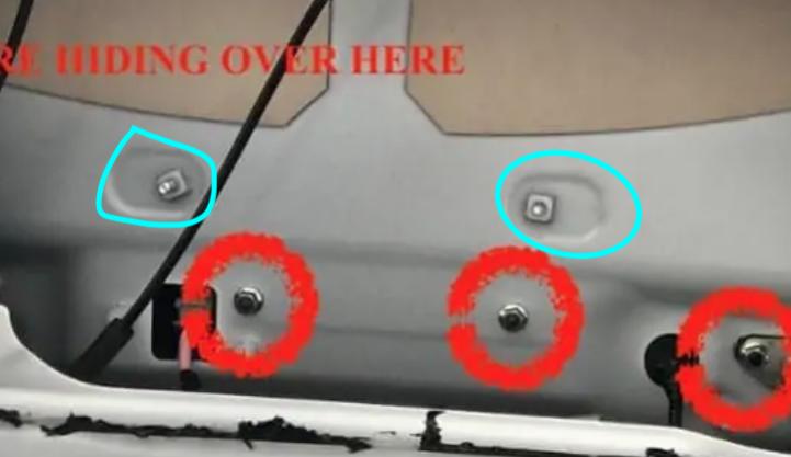

Attached screen capture:
Are the two bolts (circled in cyan) the license plate holder nuts/bolts?

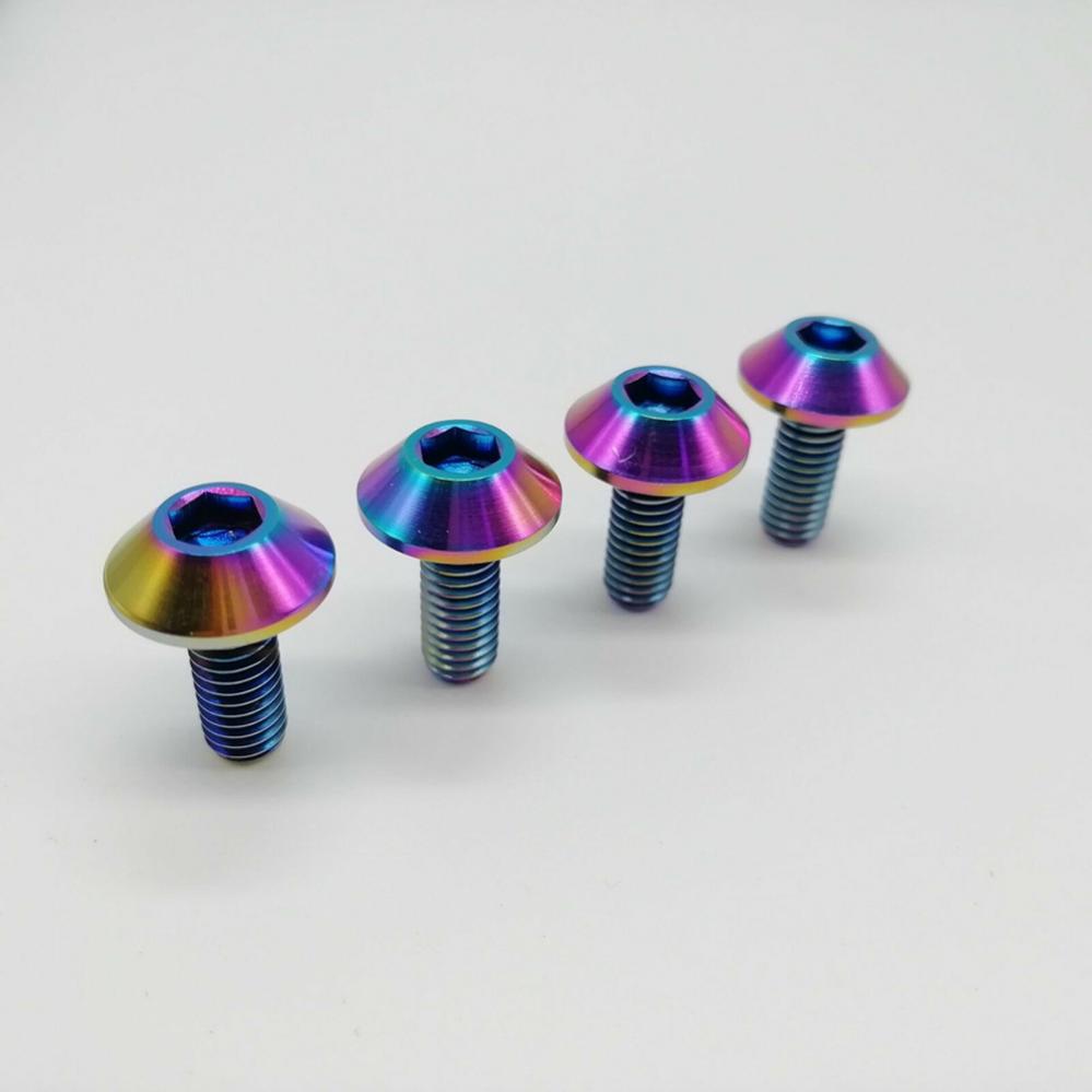

Looks like you're probably right. I would think the nuts for the license plate mounts would be welded on like the ones shown in your picture circled in blue. This is actually one of the reasons I swapped out my license plate bolts with titanium ones. Good luck !
Link to these Ti bolts?
