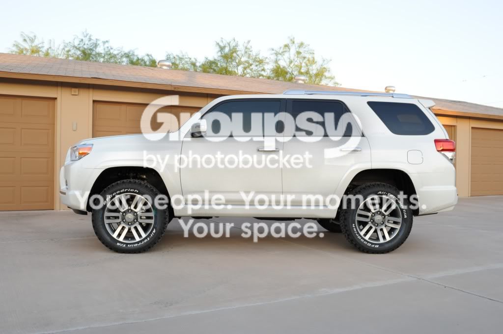

I hope the result will look like [thanks [MENTION=70138]T4RAZ[/MENTION]]...
