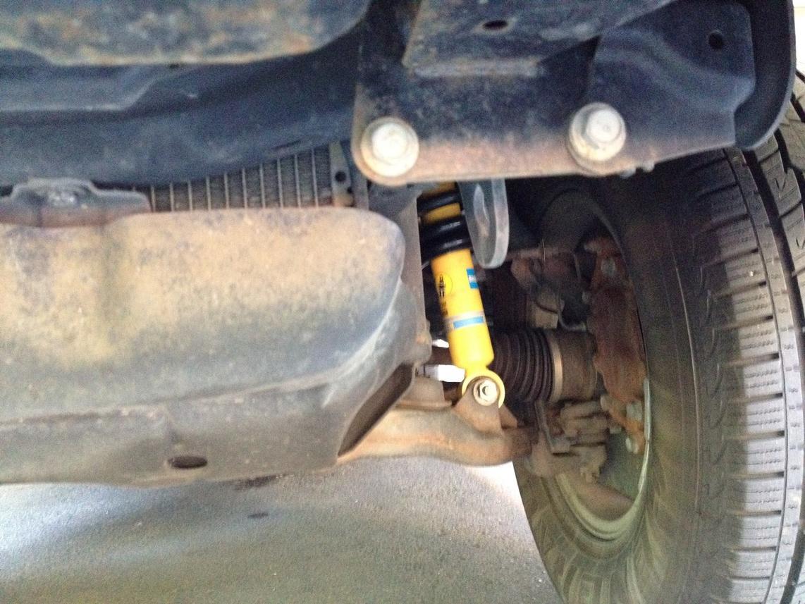

One thing I would HIGHLY recommend anyone prior to doing this or any other kind of mechanical work on their 4Runners, take detailed pictures before taking things apart! My buddy and I had to repeat the installation of the front springs because we foolishly installed them upside down. Yes so that meant taking the struts out, and messing with the spring compressors again. Ouch..

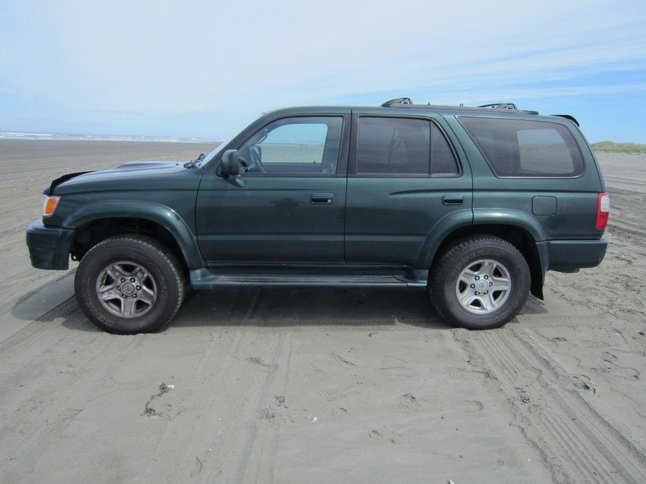

The first picture shows my 4Runner with just the fronts installed since the first day we ran out of time due to the above mentioned mistake. Please do laugh at the rear sag :).

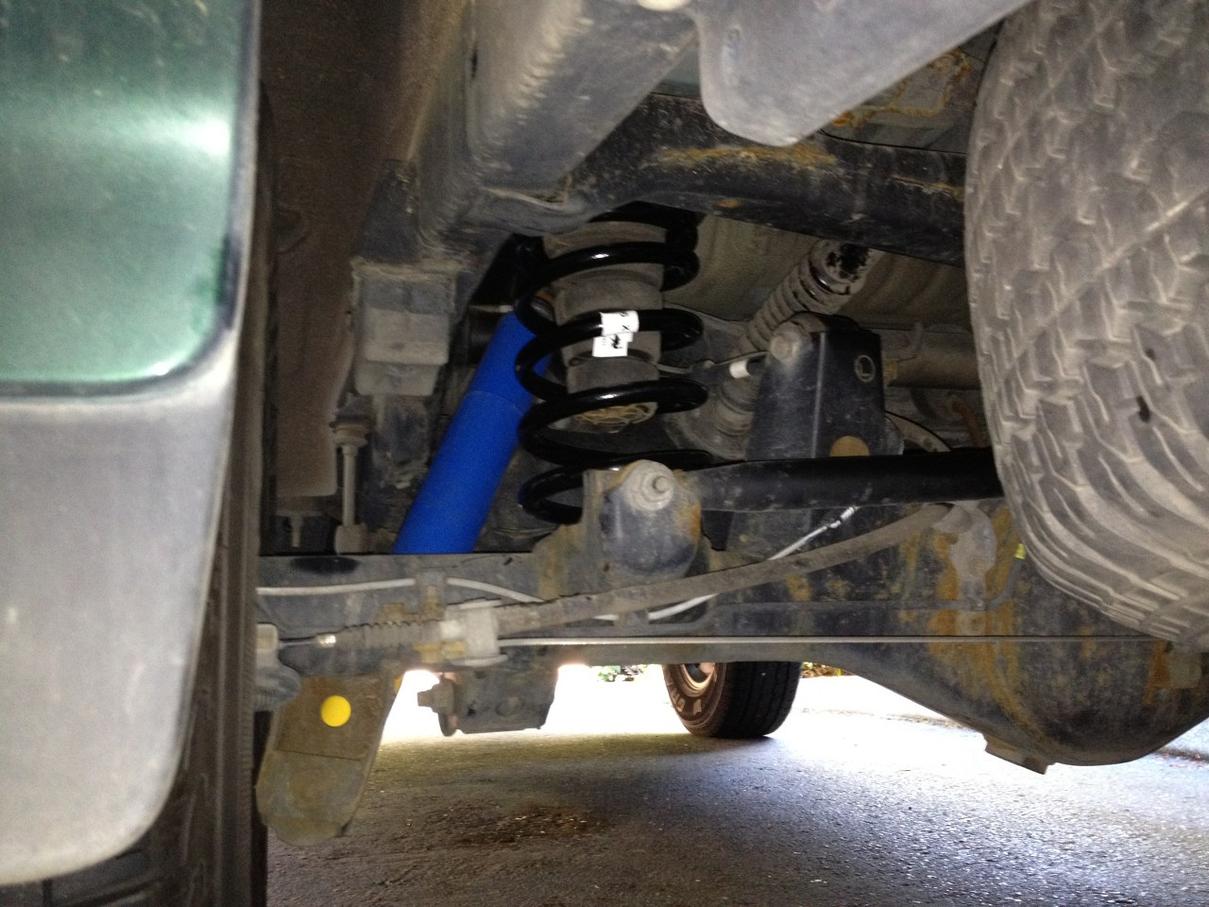

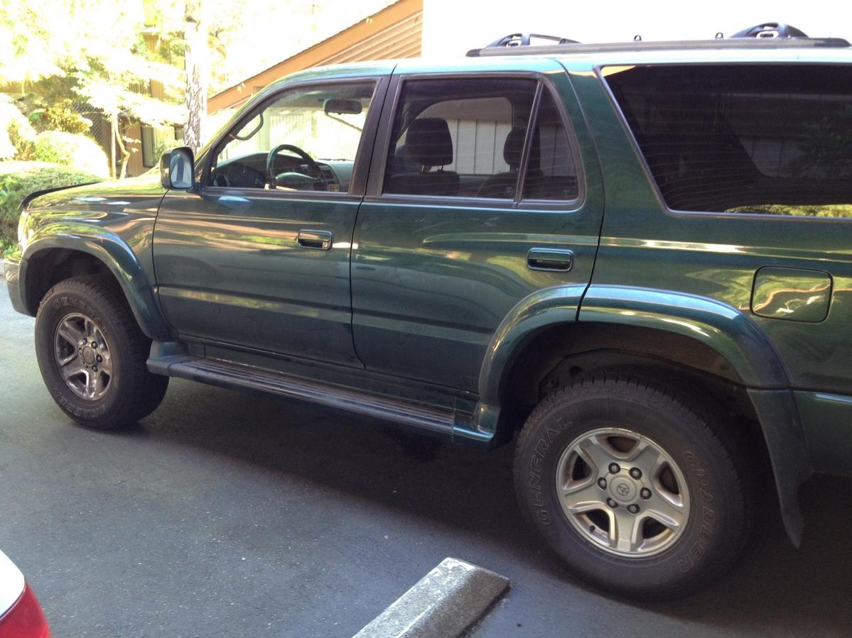

Next shows the final setup installed! :cheers:
I noticed that the OME 906s are much thicker than the stock rears. So this will definitely stiffen things up in the rear.

GSPRunner: Yes this was at ocean shores. Love that place. And I'd say the beach driving was 1/2 the fun with only the fronts installed at the time.
