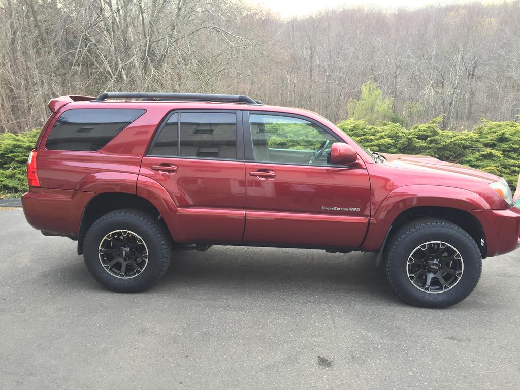

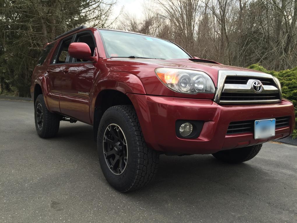

She needs a bath and I'll post more but here is my 07 sport Ed with new parts. Fj coils all around, Billstein 5100s all around, set at 1.75 in front. 1" Cornfed spacer in rear. New ultra spline wheels with toyo open country at2 265 70 17 tires. Love it

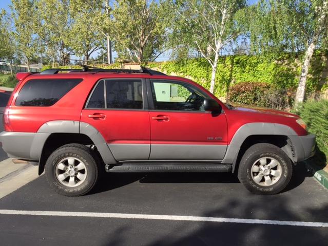

Very nice, turned out great! I did exactly the same lift last week on my 2003 V8, but haven't gotten around to the wheels and tires yet. Unfortunately I have about another 20-30K on my 265/70/16s before I get to replace them. It's interesting how much better your tires fill the wheel wells than mine considering they're just one size up.
