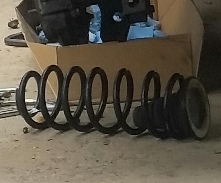

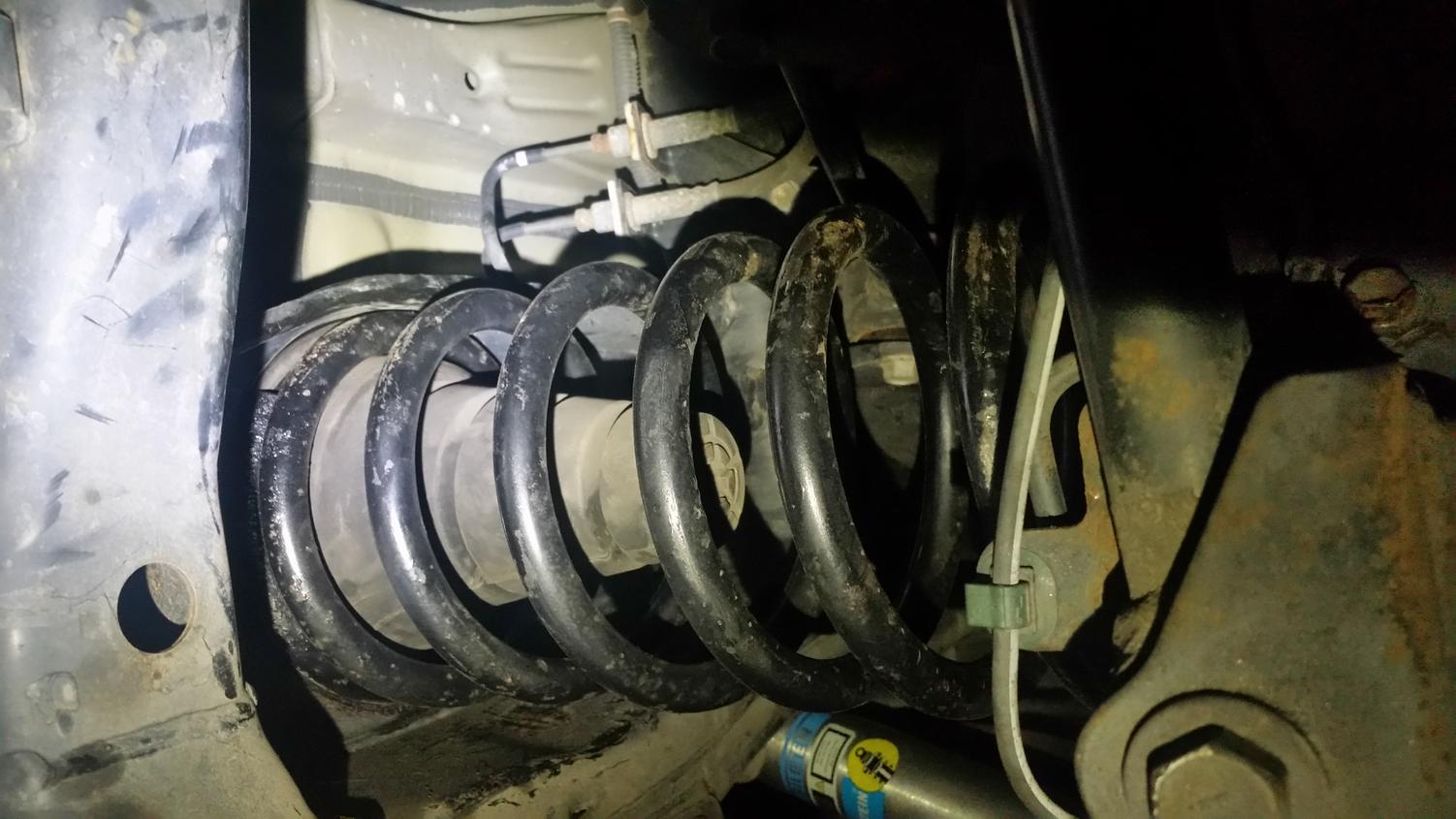

I have no way of measuring the free height or thickness unfortunately. These two pics are crappy, but all I have for the coils.
