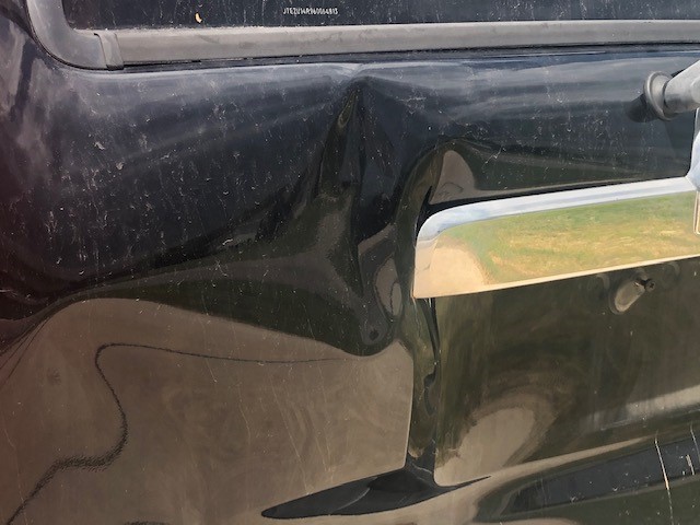

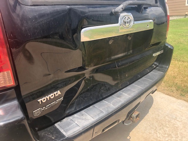

I always wanted a 4Runner, finally bought one a 2006 SR5, I got it super cheap as it needs a little work but nothing major and only had 150k miles. Has some damage on the back, I would like to get the dents taken out so it looks decent, doesn't need to be perfect for the price I paid. I have taken it to 3 body shops that were recommended and I was told would "help me out". I explained the situation bought it cheap just want the dents taken out doesn't need to look perfect, this isn't an insurance claim, there is no insurance money this is out of pocket. All 3 came back with quotes to replace the rear lift gate assy at over half of what I paid for it. All 3 said they wouldn't be able to do the job of just fixing the lift gate on the rig. I would much rather spend that money on a lift, roof rack, wheels & tires, etc.
Sunday I am running around town with the fam come out of a store and a guy is looking at the back of my 4R, I walk up and he ask if its mine, I say yes. He asked if I have thought about taking the dents out of the rear, I said yes I have been to 3 body shops and all 3 said they can't do it and quoted me brand new replacement. He said BS man, I will fix your lift gate, I can do it right in your driveway or wherever you want, it will take me 3-4 hours and I will charge you $600. Given the 3 body shops I have already been to I don't really want to waste time going to more, I am seriously considering this guys offer, but would like opinions, whats your opinion?

That looks like a tough one but if you have the right tools maybe not. Does he have any references he can give you? Will the door still need to be painted or is this just to take as much out as possible? What if you're not happy with the results? I don't see that being close to normal without some body filler after the major dents are pulled.

He said that would be ready for paint, he would paint it for $1,100 total for both.
For $1100, it would be much less risk to get a black tailgate from a junkyard and install it with a few buddies. I think you can find them in junkyards anywhere from $500-$1000. Even if you have to drive a few hours, driving is cheap. Then you also still your old complete tailgate with only cosmetic damage that you can either part out or sell whole. Tailgate issues aren't super common, but you could probably sell the internals and spoiler to get a few bucks back.
Agreed - I think it just depends on how patient you can be. Keep an eye on used-car-parts, eBay and Facebook. Tailgates should be around 500 and then 200 at Maaco to paint
Run do not walk
This is a popular scam here in Illinois for quite a few years. They fill the dents with 'plaster of Paris' type filler. They will come to you so you cannot find them again.
I just did a search on eBay, and they're not as expensive as I was expecting. Definetly going to be cheaper if you can pull yourself, but even with shipping these are mostly under $1000 and are already black. Oddly enough no spoiler on any that I found, but those are really just cosmetic.

The 03 4runner I bought wrecked had a liftgate that got damaged by a copart forklift operator with very similar damage to yours, just not as bad.
My brother does body work and did the repairs, and from the looks of it at first we thought we could maybe PDR it. The metal there (especially once it creases) is stupid thick and did not want to be worked at all. It took him close to 40 minutes with the weld-on studs and slide hammer to get it to move close to an acceptable level before he went to body filler.
Your damage looks a bit worse, so a shop (with disassembly and prep time) is probably throwing the same 6-10 hours the guys quoted you. So for them, obviously its much more beneficial to just swap out gates.
I don't know how much I'd trust someone to do work in my driveway (not to say there aren't good people out there that do good work) though $600 seems "reasonable". I have seen people throw some body filler over stuff like this and call it good, which is far from the right way to do it.
Like mentioned above, at $1100-1600 bucks (which seems very reasonable to repair something like this ) find a used gate in the same color and call it good.
I was able to source a complete bumper, reinforcement, complete door, hood and fender from a wrecked 05 4runner in the same colors for $1200. Hood alone should have cost me that much to replace or repair.
