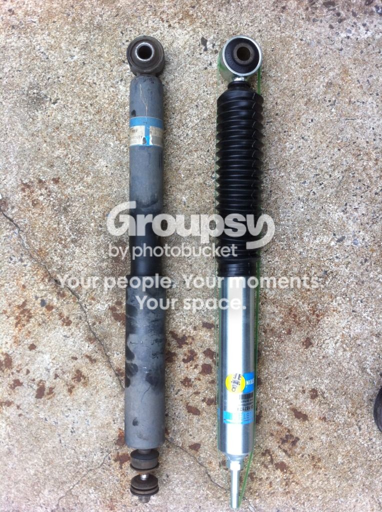

The shock bodies between the Billy's and the Tokico's are the same size as for as I know. Here's a comparison shot I took when I installed mine:
rearsuspension001.jpg~original
I don't know if there is any additional stroke gained from 5100's over stock. I know that most rear lifts, like the Superflex Coils advertise 2" of additional travel, but I think it's because of the 2" of lift provided, hence 2 inches (theoretically) of additional compression to be had, as opposed to a spacer lift.

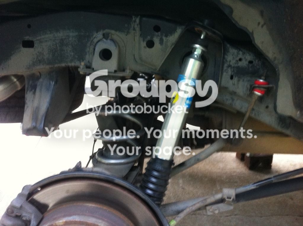

I'm curious as to how your end links look. Can you take a picture of them with the truck sitting on the ground? I'd imagine they'd be under a lot of tension like this:
rearsuspension004.jpg~original

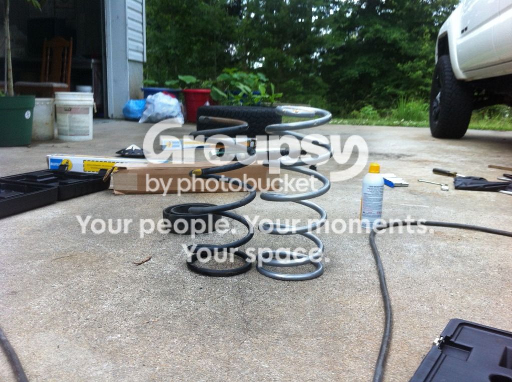

A comparison shot of the springs like this might have helped:
rearsuspension002.jpg~original
You wouldn't be able to tell, but I gained like 2.5" worth of lift from this spring. So if you say that the new spring was significantly longer, then you might have a problem...

Thank you for your very detailed explanation! Yes, I finally after taking it all apart, i realized the coils were indeed a lift coil, so i got rid of the spacer and wah lah, its finally level. My sway bar end links are looking surprisingly good actually, but i have one question. Looking at the way you mounted your shock in the rear, it seems like the bushings doing take up the left over space and there seems to be a gap, does that effect bounce at all?
Oh, haha, the shock wasn't fully mounted in at this point. I snapped the pic just after I put the threaded end into the upper mount. If you look, you can see that the upper nut isn't even there yet, the threads haven't even come up through the upper bushing. There wouldn't actually be a gap there anyway at ride height with the weight of the truck on it.
