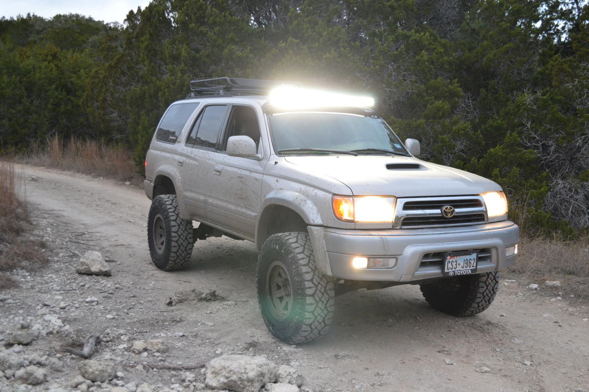

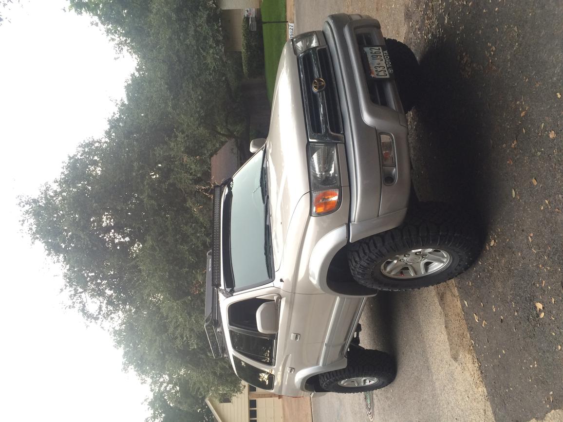

So I lifted my 2000 4Runner with Wheelers T1(Eibach) Front coils, OME 2890 Rear coils, Tundra Bilstein 5100's and it was supposed to be 3". I later discovered it was on the first perch of the 5100's, would that be 3 inches of lift? Then I got a 2" coil spacer from eBay now I don't know how much lift I'm running, is it 3"? 4"? Or the 5" I really want? Thanks!!
The picture with the stock 5 stars is where I only have the "3" inch suspension lift
The picture with the aftermarket SCS wheels is WITH the 2" coil spacer

So you added a front coil spacer and left the front on perch 1? If so you need to remove the coil spacer. Move the perch to 2-3. You dont want a spacer because if its a preload spacer it will cause excessive droop and if its a top out spacer it can cause the coils to stack during compression making you loose up travel.
We cannot tell with pictures.
What's the measurement from the center of the hub (center of the center cap) straight up to the fender?
a 5" suspension lift is going to ravage your CVs unless it's a drop bracket lift or spindle lift. You'll be much better off with a 3" suspension lift, and a 2" body lift.
Tundra 5100's with Eibach coils on the lowest perch is about 2.5in of lift.
If you added a 2in spacer on top of that then you should be close to 4.5in.
As others have said that is too much lift and will likely cause issues with your CV's, LBJ's, TRE etc....
You would probably be best going with a body lift if you want more than 3 inches.
