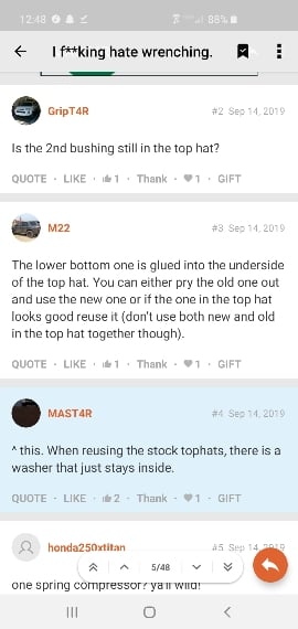

Im installing my eibach lift and have a question. The new shock up front has 2 new bushings. Should i pry out the old bushing thats in the top hat? Im reusing the oem top hats and doing the no spring compressor method. I tried looking but couldnt find out if theyre glued in or not.
Im assuiming yes take them out but dont want to ruin it if i need to reuse it.

Never mind i found the answer 2 seconds later. Fml

I recently replaced my top hats and new ones had the bushing in them as you have, I left them in. I assume KYB supplies an adequate pre-installed bushing.
Yea once i realized they were glued i just got a screw driver and ripped them out. Fronts are done. Rear once my daughter wakes up. Honestly kdss intimidated me but i took it off at the LCA and just used a wood pump clamp to get it back on. Took 5 min. Had the piston supported with a jack stand during install then used the oem jack to manipulate the piston during reinstall.

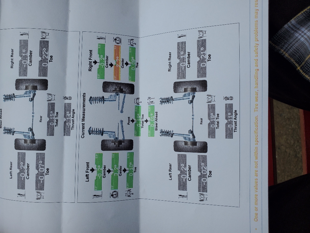

Congrats! I would be interested in your alignment results too. Thanks
Ill post them. But ive seen lots of people woth good numbers so it shouldnt be an issue. Just want to see if they can get me +4 caster

i made the mistake of adding the new bushing to the KYB mount not knowing there was a bushing inside already.. easy fix.

Completely disagree that an UCA isn't needed.
in order to get proper caster and camber angles more than 3 degrees is needed, and cannot be accomplished with the stock UCA.
That's not to say you can't drive that way and have no issues, but it will wander more, track poorly, and want to deflect under hard braking.
Asked if i could get 4 caster if they could but said they cant do "custom alignments" with the lifetime alignment. Doubt it but whatever i dont have 285s so not that big of a deal. Caster stayed at 3ish which is fine. Drove perfect on the way home. No wobble or vibration.
