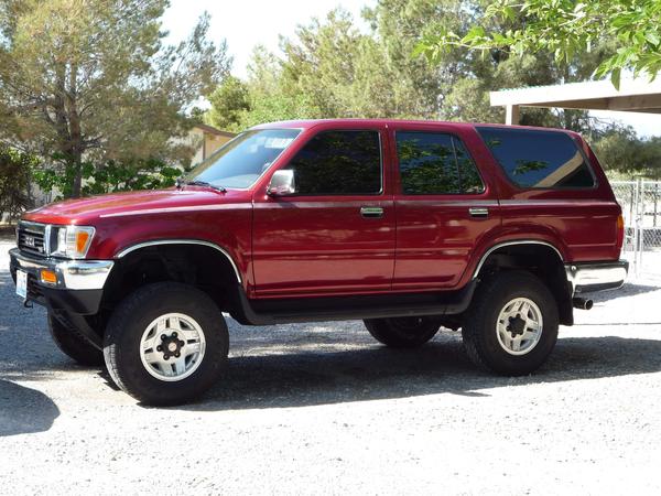

Here is a picture of 31's on a 5 inch suspension lift before I put the 33's on.
