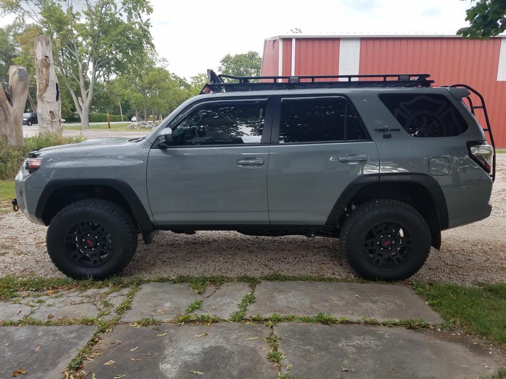

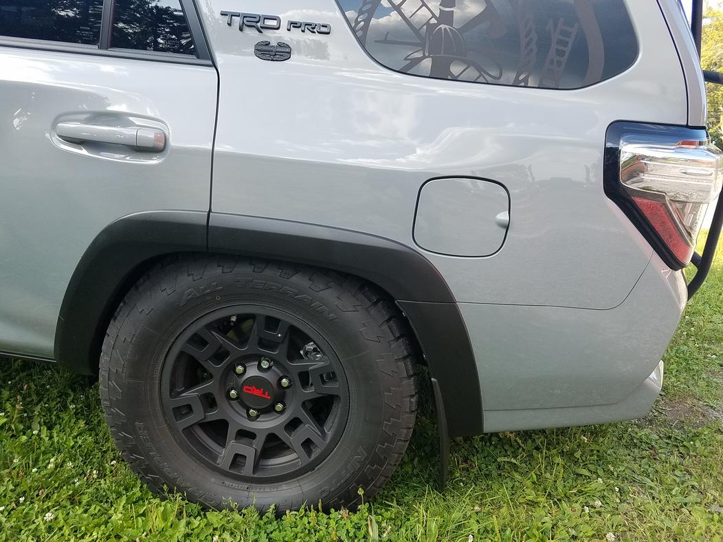

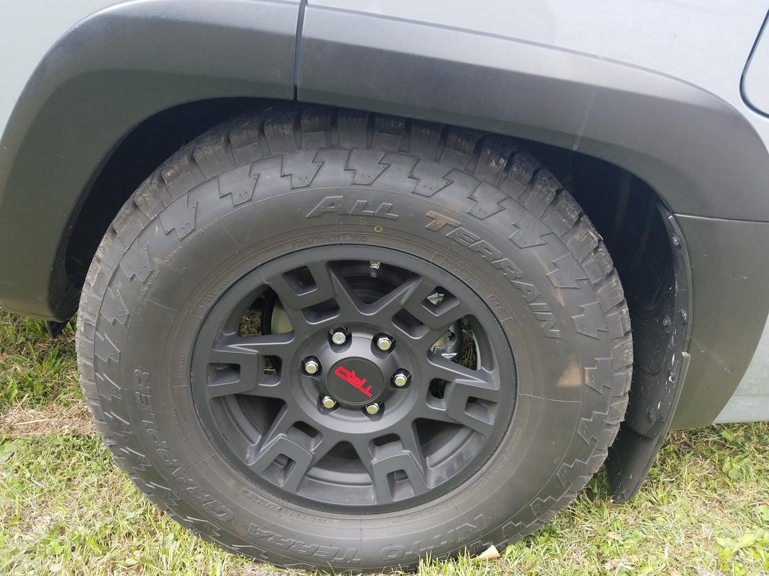

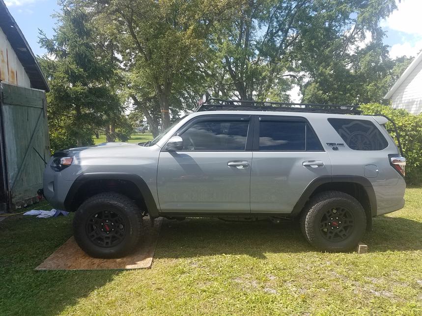

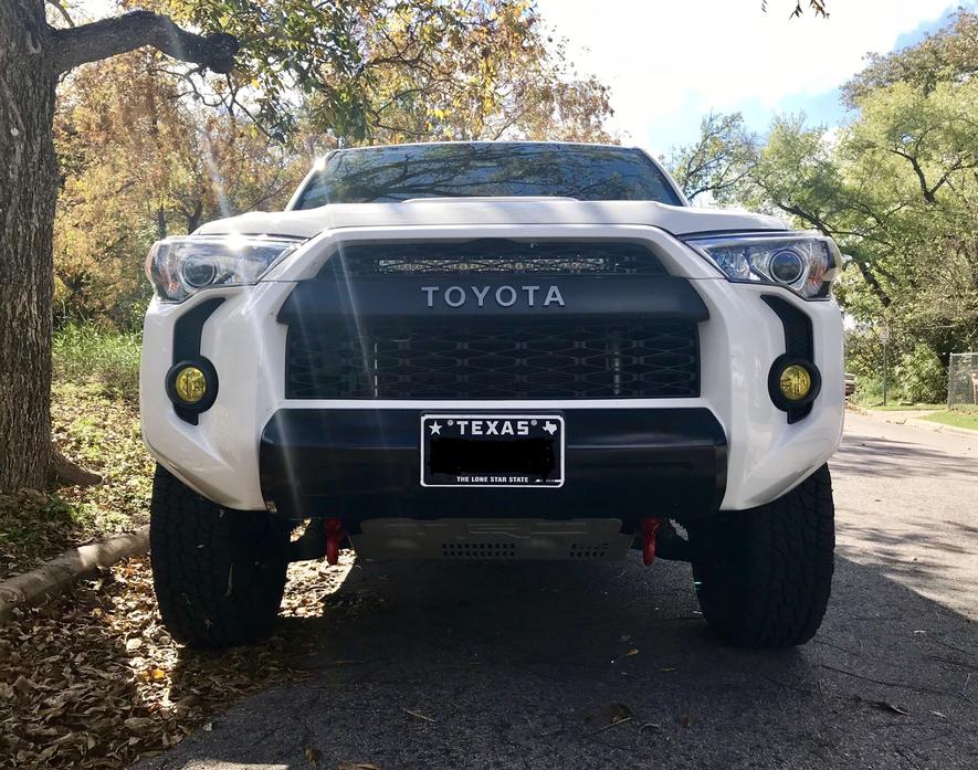

2/1.75 Installed
Front from 20 1/2" to 22 1/2" (hub to fender)
Rear from 21 1/2" to 23 3/8" (full tank of gas)
Top of lights from 6'-5 1/4" to 6'-7 1/4"

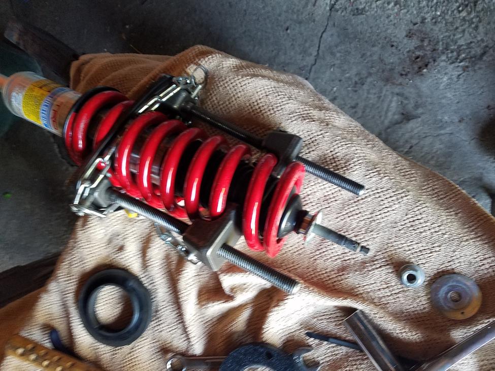

Front end took just over 3 hours, kinda got stressed out compressing the springs. First time doing that in my life and with the Bilstein I wont tell you what it looks like having large zip ties and locked chain wrapped around the bottom of the compressors so you'll have to just use your imagination (it might look like a picture i will attach that...ahem...a friend took. He might have used his free pass getting away with that)
Rear end only took 45 minutes. Did the whole job solo. used a small floor jack on the opposite sides to easily place the rear coils back in. Actually had more trouble
getting the skid plate back in afterwords than I did with the entire rear haha.
Really happy with the look and feel now, Thank you [MENTION=9]Jason B[/MENTION] for calling and suggesting the 2/1.75 rather than the 2/2 for the Pro.
There's the front in rear out.
Here is the difference fully stuffed with the right front up a 3' hill (before and after)
And there is the driver side profile completed:

Just ordered from Jason. Quick shipping to Canada and he replies fast through text!Will post before and after pictures of the 2/1 installed on my 2016 Trail.

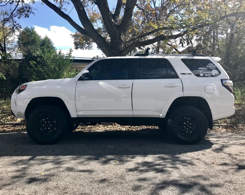

Just picked it up, very happy with the stance! Level, more aggressive than stock, and no noticeable change in ride quality!
