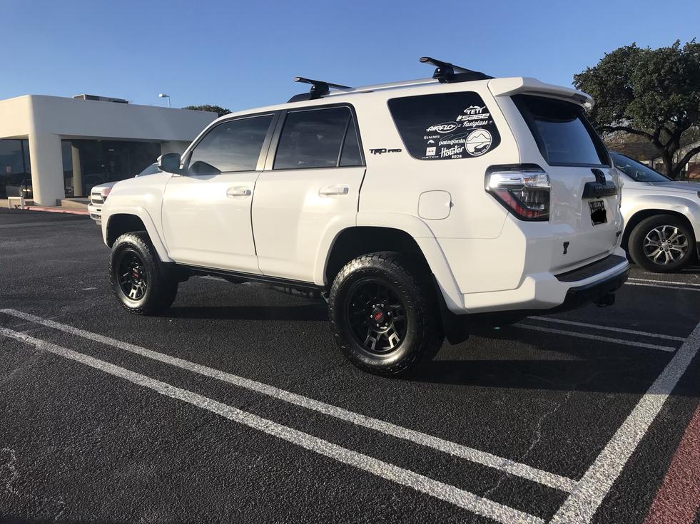

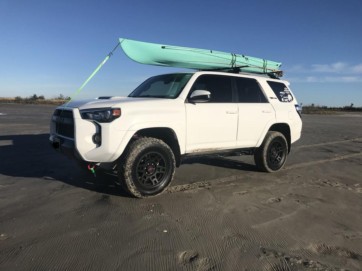

Just phone pictures, hopefully they help! I read a post that somebody fit 255/80 Coopers on a TRD Pro with fully stock suspension but we’ll see. Look at at my tire a full lock I have a feeling they’ll rub.

I am loving the mild lift on your Pro! I also like how beefy the 255/80s look too, but it might be too high for my truck to pull into the garage since I have a Gobi rack. Do you know the total height from the ground to the shark fin antenna after the 1.5/1 lift? I think I am cutting it very close assuming if I have 275/70s!
Great pics! Looks really nice man.

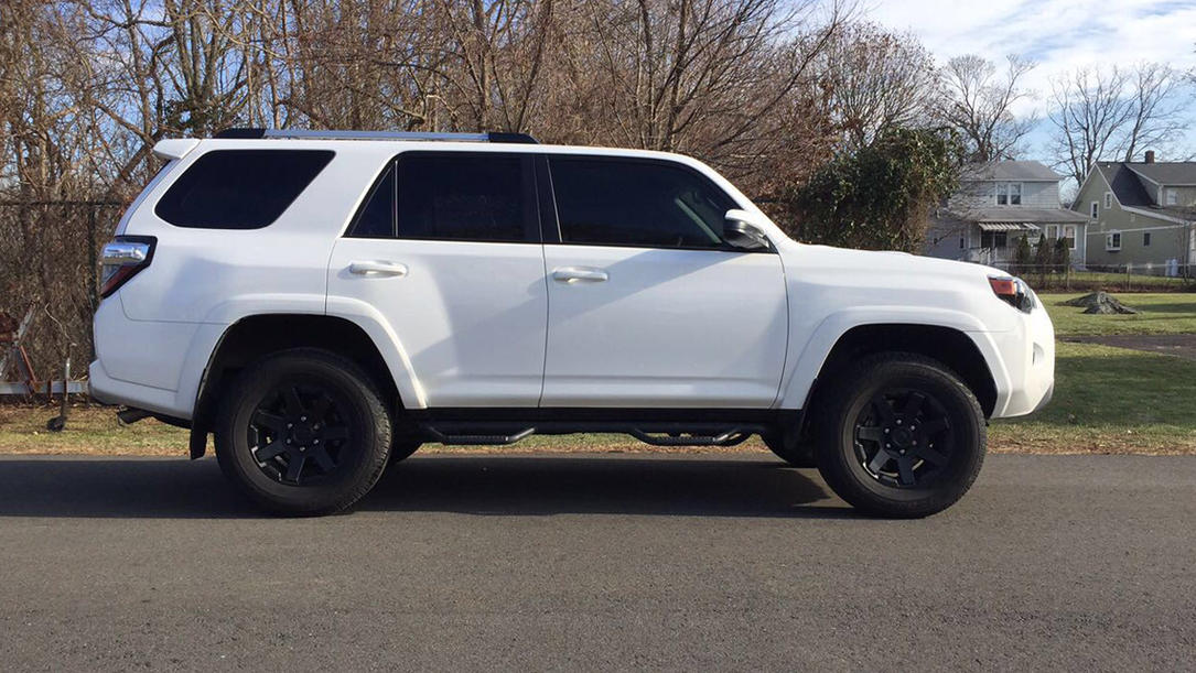

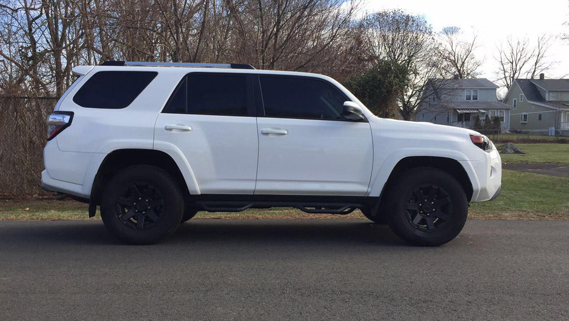

Just installed the 1" leveling kit on my 2016 TE (non-KDSS):
Did this by myself in 1 hour and 45 minutes from the time I took the tools out of the box to the time I put them back.
Hardest part was removing the 3rd coil-over mounting bolt closest to the engine. Just had to use an open-ended wrench with very short throws.
I unbolted the sway bar from both the frame and the bar link from the upper control arm.
Removing the coil-over by myself was tricky, but I rested my torso over the wheel hub and bounced a little and was able to get it free.
Very easy kit to install!
Before on top, After on bottom.

Joe Thx for B4 and After, it looks good .... are those stock size tires? Are they Nittos?...cant quite see from photo.
Thanks man! Stock tires, truck only has 14k on it. Will be scouring forum for larger/more aggressive tires when the time comes.
