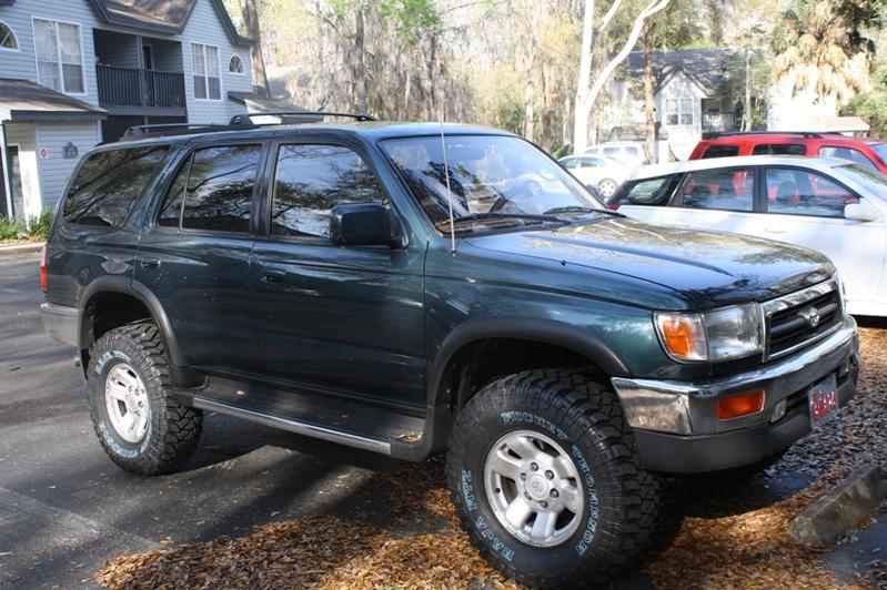

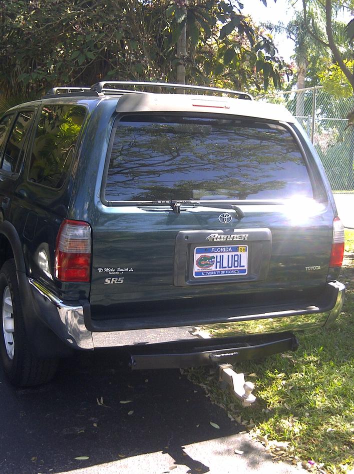

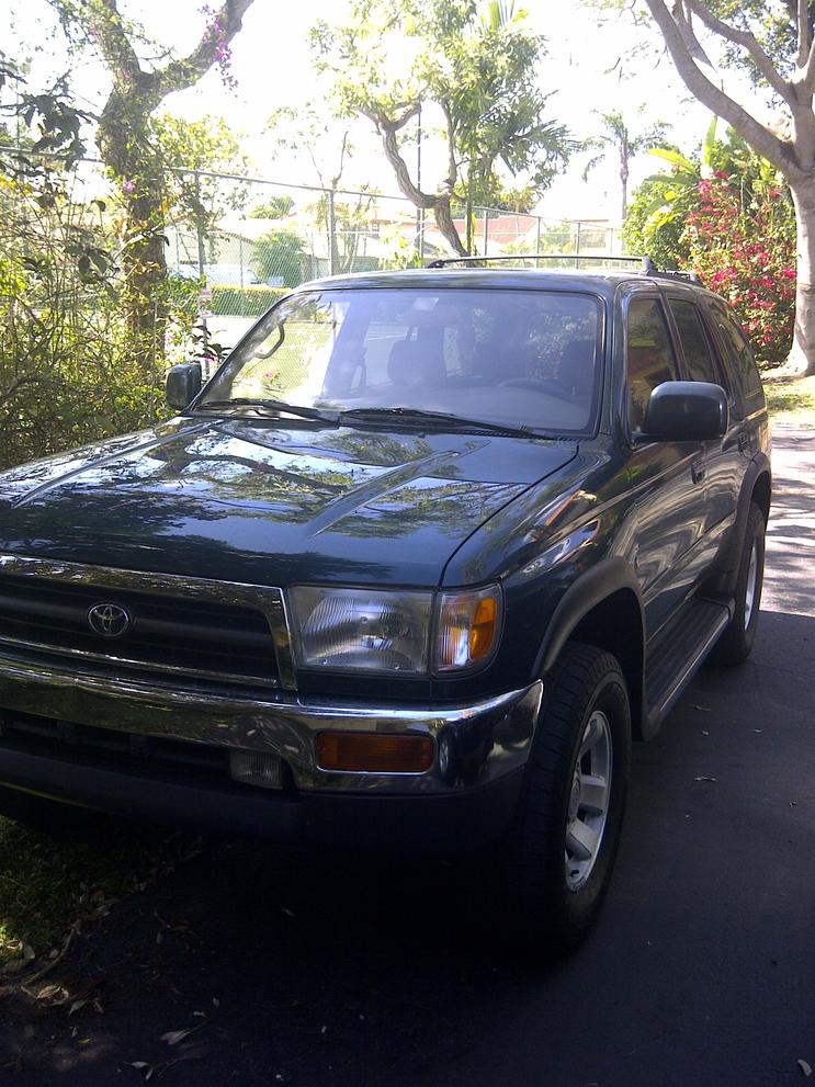

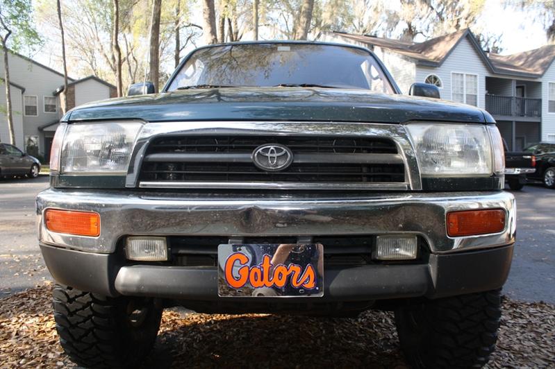

I hope this picture shows what I am talking about.

Alright guys!! Thanks for the info. I love my lift and will post pics before and after my lift and tires. Thanks to everyone.

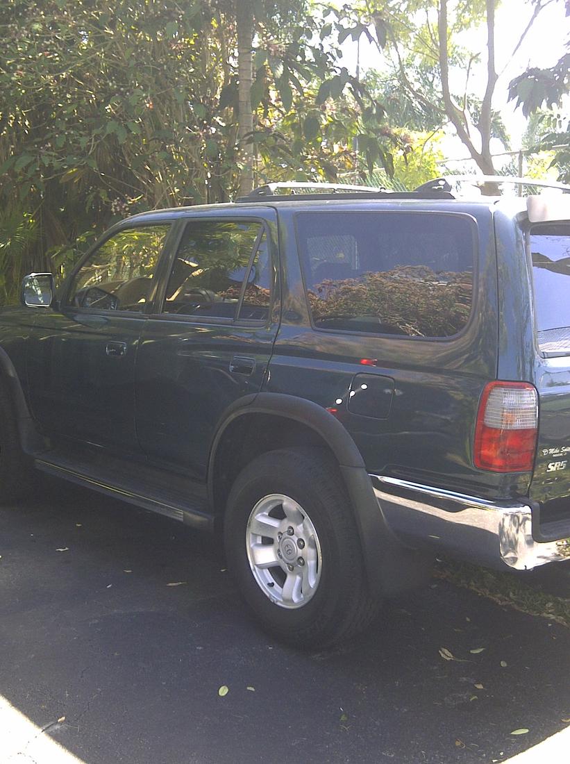

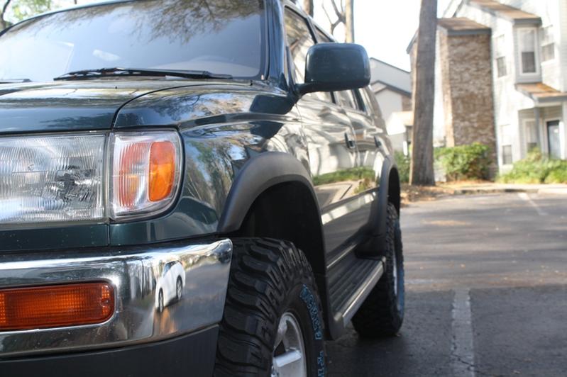

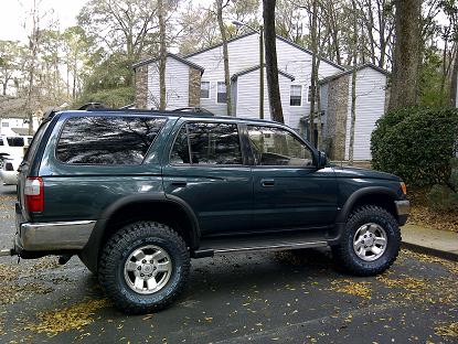

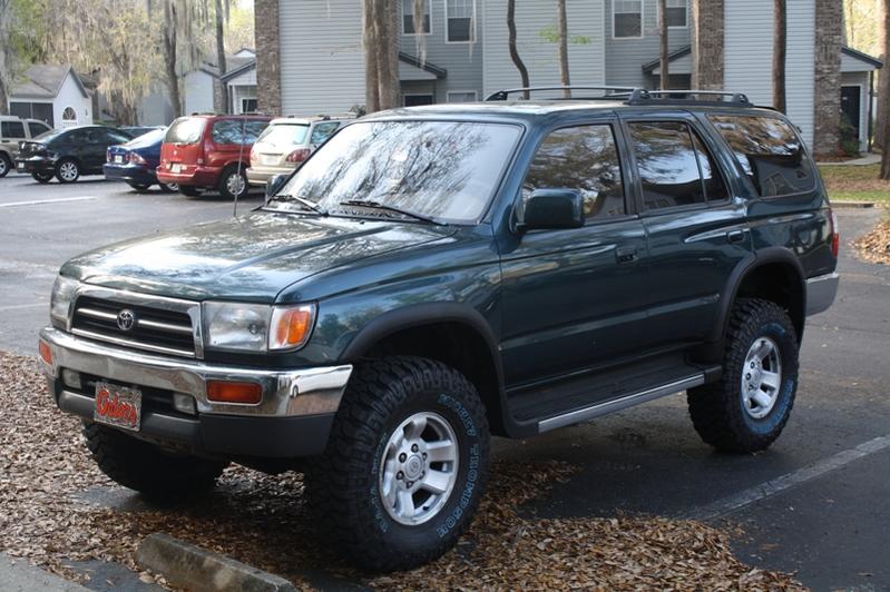

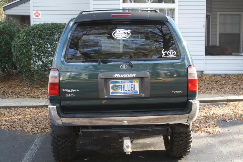

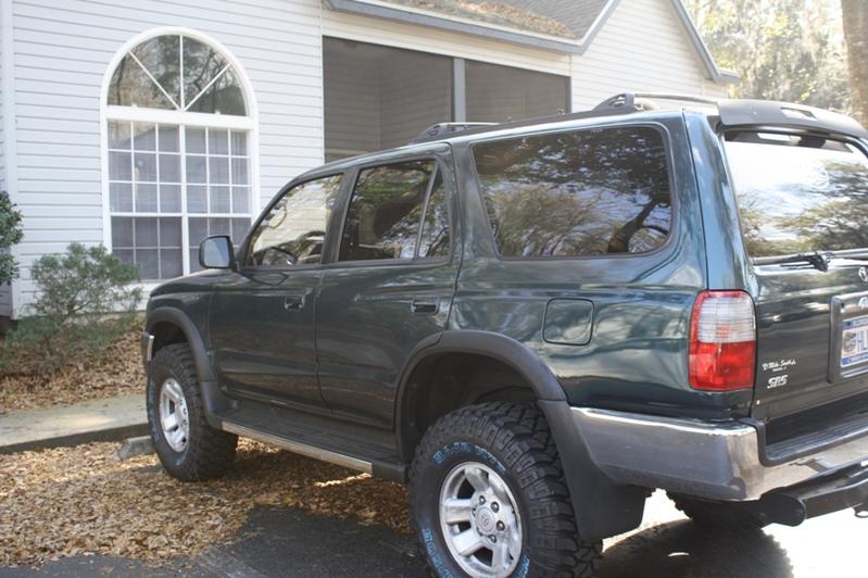

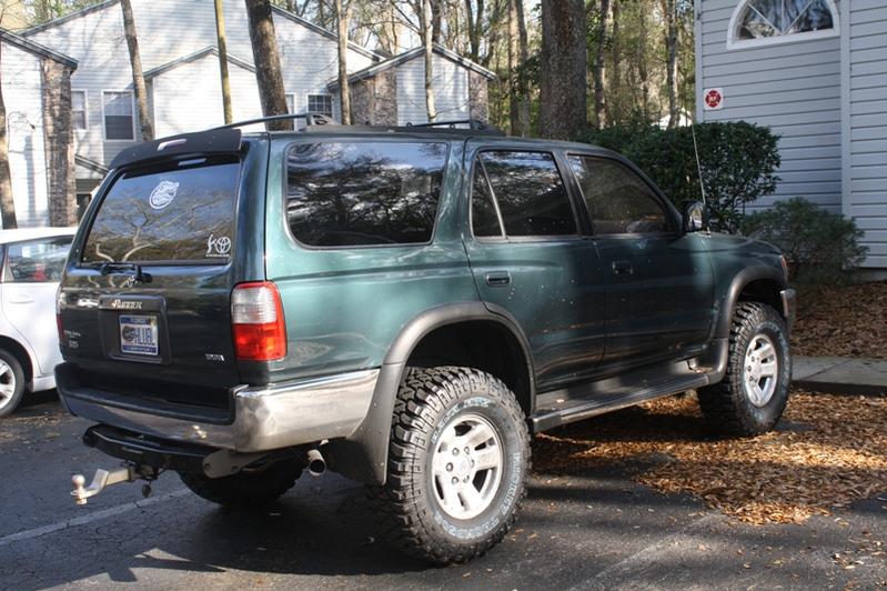

Before and after lift and tires. Please comment and let me know what should be my next mod! I am thinking snorkel!

After lift and tires. Any suggestions?

Next mod: Running board removal. Free and makes it look so much better. A snorkel is a big project so maybe start with the small stuff like painting wheels and emblems. Really all depends on how much money and what you want to do with it.
It looks good and they will settle a little more in the back.

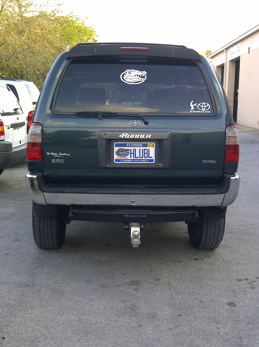

Dont change the stance it looks great. I Have to know what your rear lower right sticker says! LMAO Wife wants to know too. Go gators!
Remove running boards
I Have never owned a 4runner until Jan 2011. I bought a '97 sr5. Stock with 105k miles. Good vehicle so far. I had it for less than a week and pulled the running boards off. Looks so much better. Q, did you have to extend rear brake lines for your lift? Did you have to do diff. drop in the front? I want to lift mine, but I am not sure what lift to get or how much work it would be. I would like to do the work myself.. any advice?
Have you thought about Spidertrax wheel spacers? Push those big tires out about 1.25 inches? I've always thought that looks cool.
Thanks for the feedback everyone. My lower right sticker says "No free rides, Gas or A$$" (runnyrunnerton). I found it online and had to have it. lol. I have thought about the wheel spacers, and definitely need to buy some. On sharp turns tires rub on the inside.
I'm going to have to think about removing the runningboards jejeje.
(Viking97SR5). I did do the differential drop from toytec and NO I did not redo the brake lines. I got my lift from: Front 881 OME @ toyteclifts.com and in the rear I bought landcruiser 8 wrap coils with standard landcrusier shocks from cruiserparts.net.
I personally like the stance! I don't know, if you really don't like the rake, you can get some adjustable bilsteins, but you don't want the front too high, you might have issues with your CV axles.......
