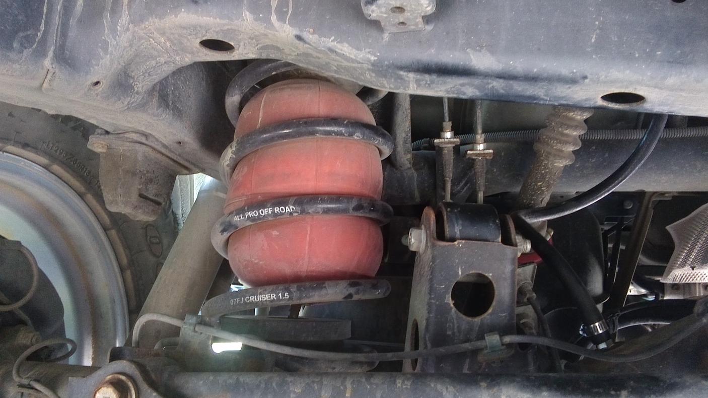

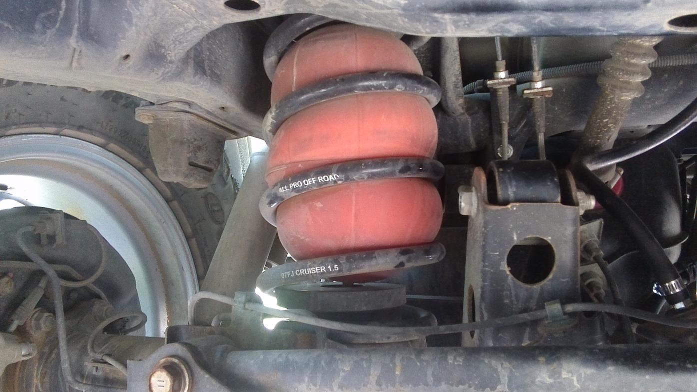

Question on these airbags if you all don't mind: I've read several statements that airbags added to a stock rear coil (no lift, no spacers, etc) will give 3/4" lift at max inflated pressure of around 35 psi. So does that mean if I install a 2" lift spring in the rear, do these air bags only "work" when that extra 2" (or whatever extra length the lift coil is over the stock coil) is taken out of the suspension in the form of squatting under load?
I've used air bags on our diesels on the farm before, but never in a lifted coil spring suspension, thus the reason for trying to wrap my head around how they work when loaded or not loaded.

Attached a couple pics of the air bags with the 4runner totally unloaded. The first should be at 0 psi and the second at 35psi. To answer your question, yes you need to take out a little slack in the springs for the bags to work but that makes mine sit fairly level with a load.

Thanks for the pics man, that explains everything very well.
