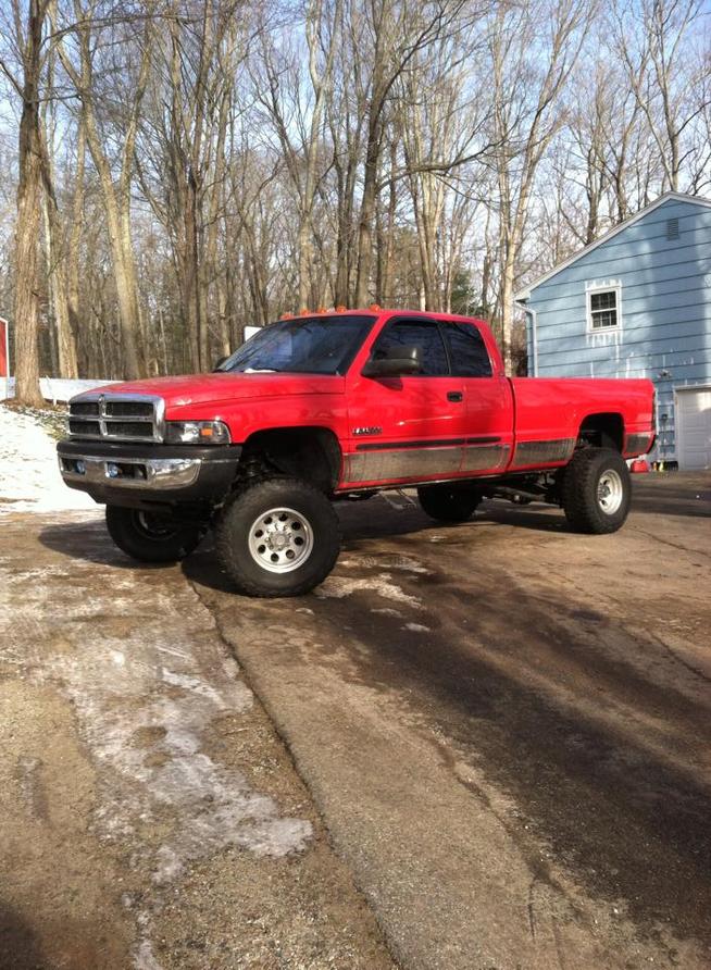

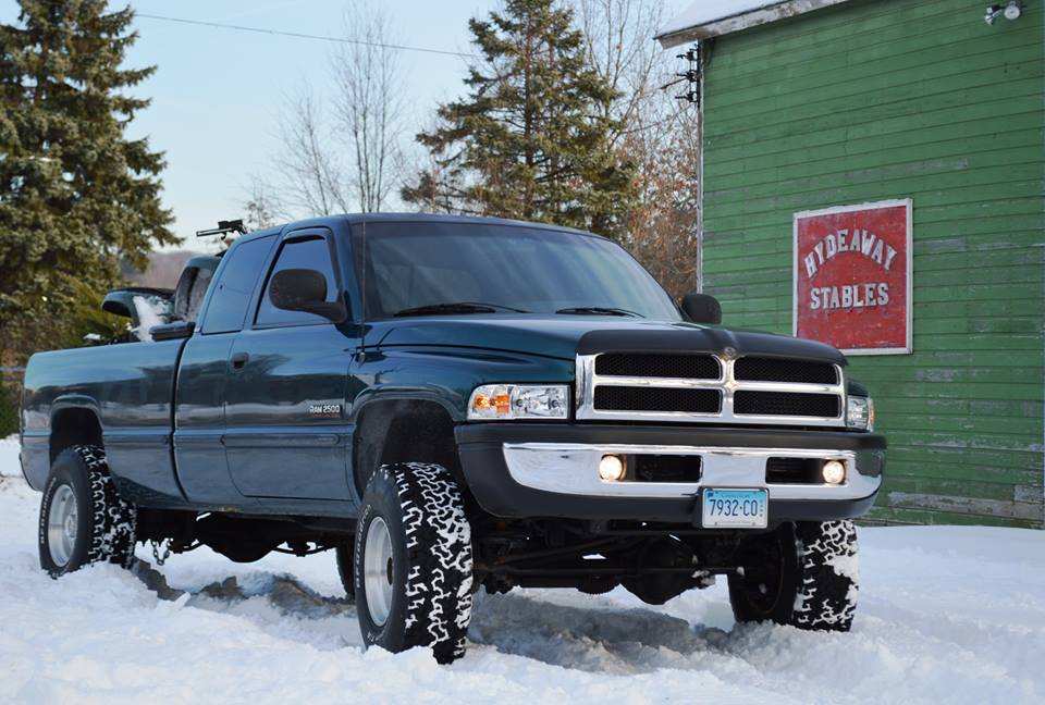

while were sharing..... my roommates last two
