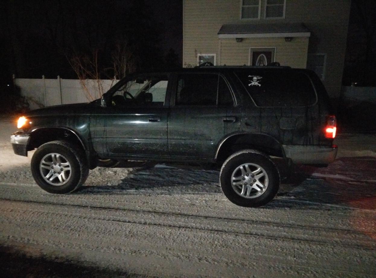

Just finished installing toytec 620 paired with tundra 5100 bilsteins on first perch, with lc coils dp/b/w with OEM lc shocks in rear. I'm happy with the little rake I have might have to install the rear spring cone bushings for a little more rake if it settles too much.
I am having a slight vibration felt on the gas pedal when vehicle is moving though. Maybe alignemnet will help idk

Haven't driven it much after lift since couldn't get alignment done. Tie rod adjustment nut seized with rust. No added weight in the rear, spare tire removed. Also I didn't reinstall rubber cone stops on top of springs.
