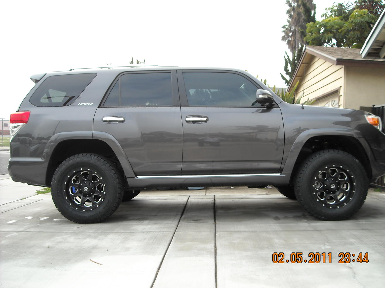

I think this is the option I'm looking at the heaviest. Any of you guys with this setup have any pics?
This is my 3"/1.5" toytec spacer lift set up before the icon suspension where installed.
