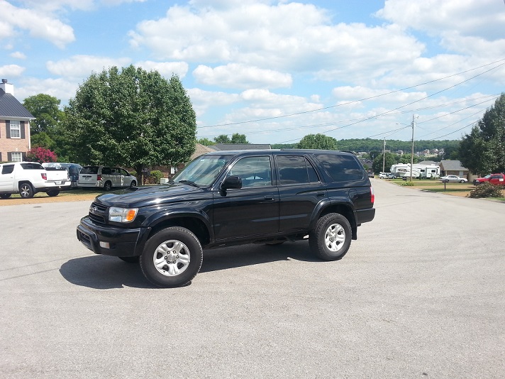

Ok, here she is after I upgraded the rear coils to 99s before I got my new tires a week ago.
I've been really liking the height of the 99s in back, and although I was originally planning to do the Tundra front coils/ OME 906 rears, I'm not so sure I want the extra height now.
