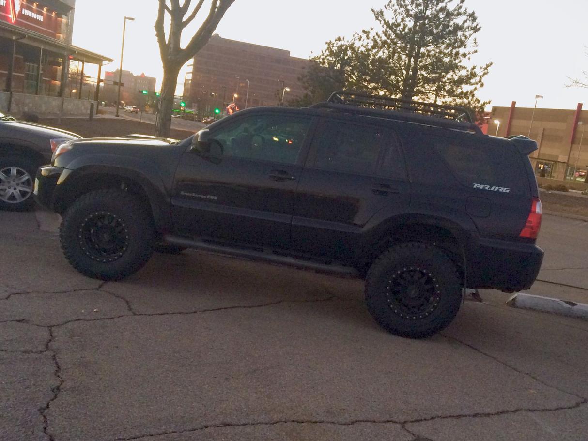

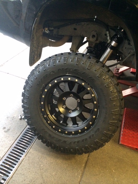

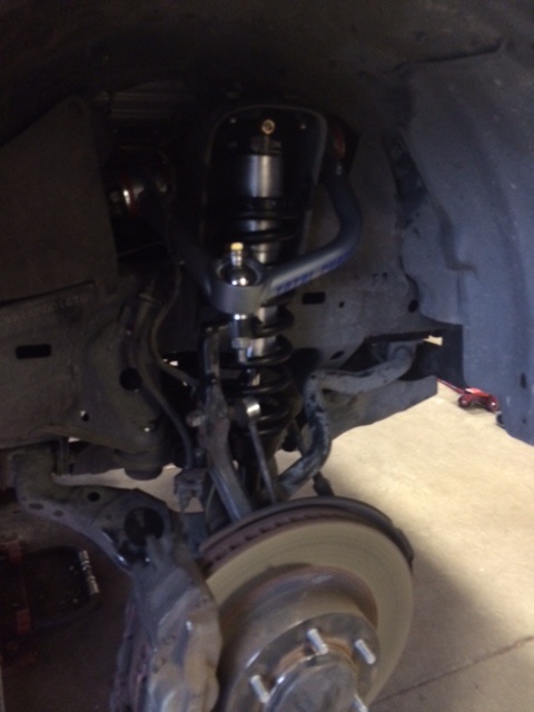

I just did an ICON stage 2 lift (coilovers, total chaos UCAs, 2" icon coils, 2.5 remote resi shocks in the rear) on my 08 Sport.
I cant say much on longevity, due to the fact the lift is pretty new, but other members on the forum say good things about ICON.
But Ive done 500 miles on the suspension and thus far and love it, a little bit stiffer than stock but awesome on the trails! Im sure the suspension will break in over the next few months.
Personally if your gonna spend the money on a lift and want a quality set up I'd go with anything that has real coil-overs the bilsteins are nice but if I were to do it again I wouldn't have wasted the money on inferior parts.
Pictures ICON Stage 2
Suspension
Icon stage 2
Total Chaos UCAS
2.5 Remote Resi in the rear.
2" Icon Coils
Wheels
Method Standard 17 X 8.5 ( 0 offset )
285/70/17 Goodyear Wrangler Duratracs (Love these tires so far)
