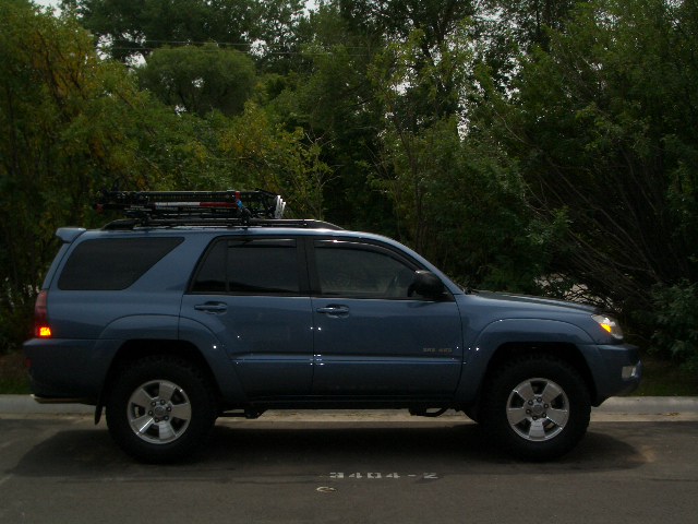

I just lifted my 4runner an inch in the front and it looks way better but the rear is still one inch higher then the front. With 255/75/17 BFG mud terrains and the one inch lift up front from the pavement to the front fender is 35.5 and the rear is 36.5 but it actually looks pretty level if you do decide lift the front 2 inches I would definately raise the rear at least an inch. Before the lift mine was 36.5 rear and 34.5 in the front so in theory you could do just 2 inches in the front but you might look at little front high usually people just do one inch up front to level it out there is cheaper ways than those pricey bilsten's to raise the front anyway just my 2 cents hope this helps
*Sigh* Such a good looking 4Runner. Such a great color! ;):
