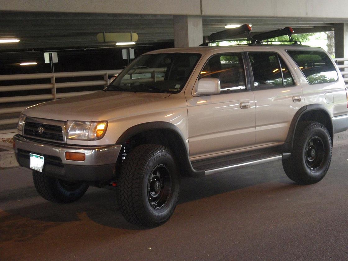

Ok, so I just got my 96 4runner lifted with a 2.5 inch Skyjacker kit, had new Procomp Shocks and Struts put on, bought 16.8 procomp xtreme alloy 7089s and procomp 285/75 all terrains,
I also have yet to install my cold air K&N kit and new sway bar links (one is broke)
but I was wondering about a 1 inch body lift, here is a pic of my Runner, what do you guys think? and if I did, where should I get it from and what brand should I go with?

If you just want a one inch get it from 4crawler or toytec. If you go over one inch go with 4crawler.
A one inch body lift would look good. Its really what you want in the end. If it were me I'd probably just lift it higher with a suspension lift before I went to a body lift, but that's just me.
He is almost maxxed out on the suspension due to the cv's. A 1 or 2 inch body lift wouldnt be bad but dont get 3 inchs.
Yeah, wouldnt want more than an inch cuz then the tires would get swallowed up by the car and I dont want to go bigger and regear...

I like the way your runner is looking, if you do a body lift 1 inch is all that I would go, I have been contemplating doing the same. If you remove your running boards that will also make it look a lil more rugged and give some added clearance. Since you are in town check out IRBIS offroad, they have some sick custom front and rear bumper setups!!

Yeh i guess I didn't really look and notice that he was at 2.5" already. 3" is really all I'd push it in the front for the sake of the cv's. 1" body lift wouldn't be too bad.

you should look in to the b.l. i am as well. i have a 3 inch suspension lift with the same size tires and last week i hit a fairly big ditch on a dirt road and my front tire came all the way up and smashed the bottom of my fender the added clearance of the b.l. would have prevented this. it tore the sr5 fender trim off i jb welded it back on and its all good
