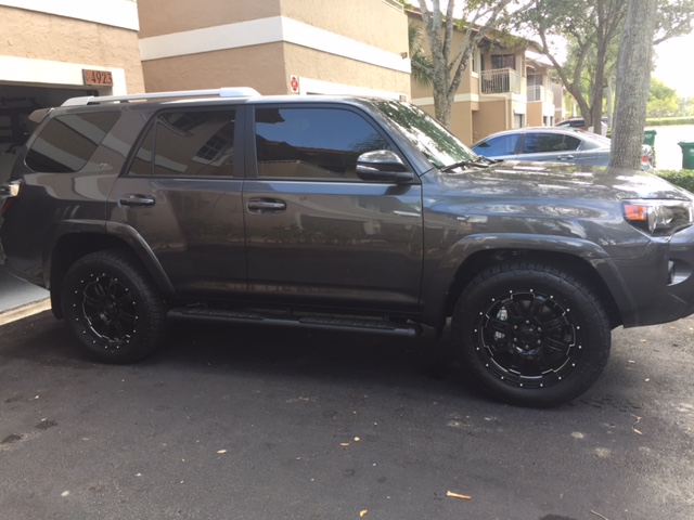

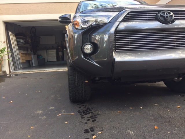

Hey everyone so I wanted some thoughts on a mini lift for my new XP. I don't want to replace the rims or tires since their only 5 days old but was thinking about either just doing the following...
1inch spacer to the front
or
1.75 front and 1inch rear spacer
What do you guys think? I am planning on getting larger tires later down the road after I get my monies worth of the current.

Why don't you drive it a little while and see how you like the shocks? If you find it a tad soft like many, put 4 Bilsteins on it and set the front to .85 to level it. Or go up a notch and put spacers on the rear.
Do a more serious lift with the new tires down the road.

OK we are going way off thread here. I appreciate all the replies and I like the rims and tires on the truck now. When the tires wear out I am going to go a tad bigger on the tires. Yes its 2WD drive who cares? I live in SFL man! We don't get snow, we don't have hills, I have more paved roads here then off roads so its mostly being driven on the pavement. I just wanted some thoughts on 4 new blistin shocks. Front set to 1.75 with 1inch cornfed spacers in the rear. Wanted some thoughts on if it would look meaner then stock and not like I have little tires with a big wheel gab. :car:
If you are going for the look just go ahead and get the 5100's like Phil said and the spacers for the rear. Only thing I would say contrary to that is- if you want it that way just do it and enjoy it now rather than later. I have had many, many cars and trucks that have been modded heavily and it's more fun to do the bigger mods first.
To answer your other question, I ran 265's for years with a 2.5" lift up front and 1.5" in the rear. Looked pretty good IMO. I definitely like the 285's better now though.
ok I got 265/55/20's so then a slightly smaller lift would look good. I figured 1.75 and 1inch would be good from pics I have been seeing.
Gonna look awesome Brother. However, if you're going to go larger on the tires later, you may want to consider 2.5 on the front Bilsteins and a 1.5 spacer in the rear. Changing the front height on the Bilsteins is as hard as installing them in the first place. Have fun. You're gonna love it.
