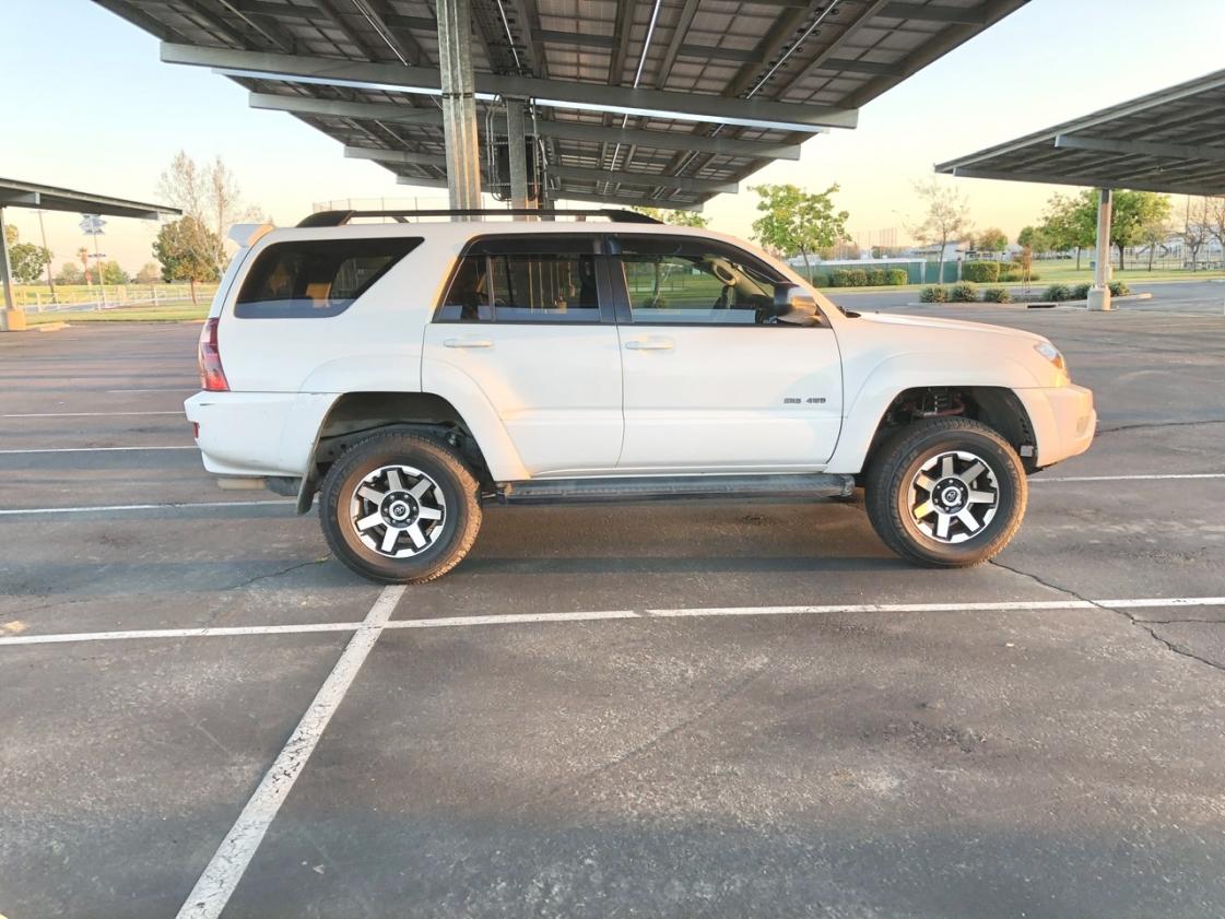

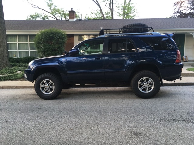

2004 Limited V8 4WD, roof rack and 2 ~heavy amplifiers in the rear cargo area are the only real extra weight. Spare on roof rack.
Lift: Daystar 2.5” front/1.5” rear spacer lift, 1” Toytec body lift.
Center of wheel to fender:
Driver side front: 22.75”
Passenger side front: 23.00”
Driver side rear: 23.00”
Passenger side rear: 23.00”
Stock 2005 V8 with 150k miles. Would this be considered sagging?
Front: 19”
Rear: 20.5”
