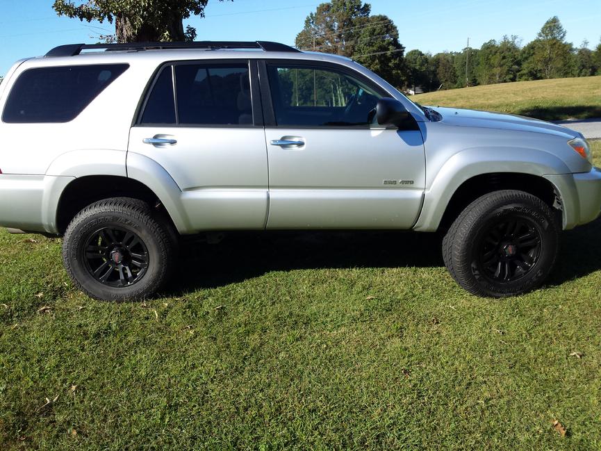

Sorry not the best picture but snapped it while chasing my son in the yard...it's easy to tell it's not level looking at either side
