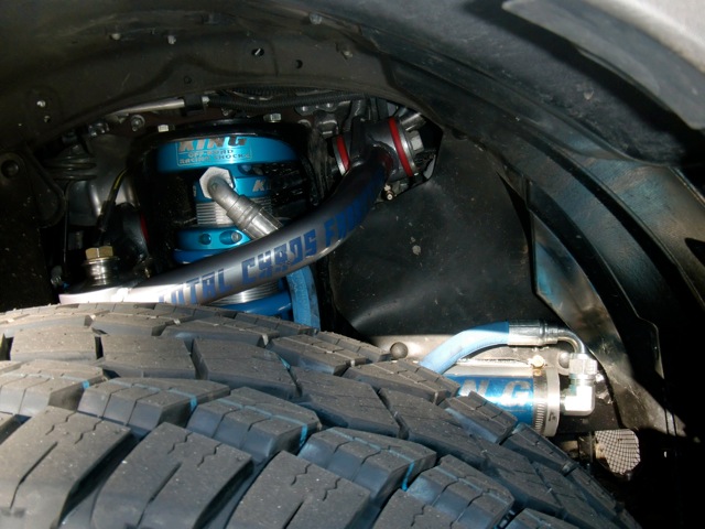

Lifted King Suspension + Gobi Rack + Light Bar
King Shocks, Total Chaos uca's, Icon 2" lift rear coil springs, 285 70 17 toyo open country at

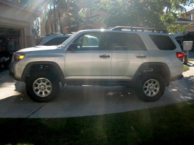

Looks great!!...could you go into some detail about the difference in handling/ride quality?
I'd love to have something done like this, but I'm afraid it'll destroy my gas mileage, or dramatically reduce handling, as my TE is my DD.
Thanks for any input,
Pat
thanks for your comments, as to handling to soon to tell, but drove like 10 miles on freeway and felt great almost the same probably less body roll (to soon to tell) and a little stiffer on small bumps the rest great so far, also speed reading did not change due to tire size i put a garmin gps and the speed reading was the same, i will update information on handling and overall feel etc later, so far i'm loving it, looks great also, i parked outside costco and when i came out there was a guy taking pictures with his cell

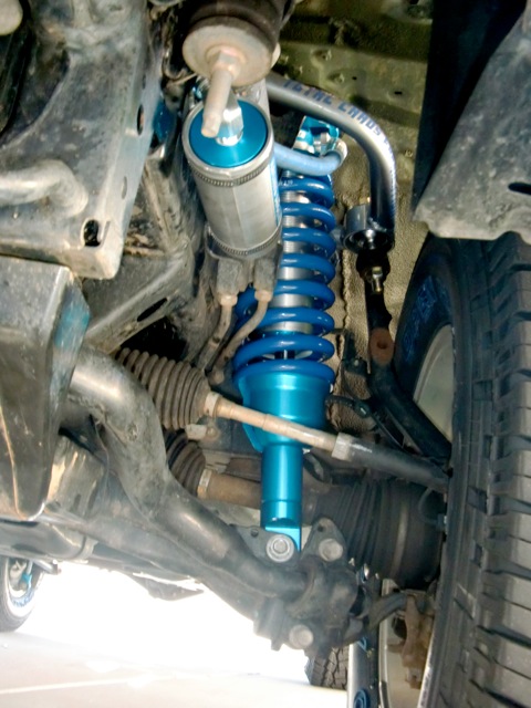

I would love to see some pics of the rear shocks. After seeing your setup I am going to do the same thing. Those look mean. I don't plan on jumping my car or having the shocks get that hot, but those look mean.

thanks, i will post better pictures in a couple of day

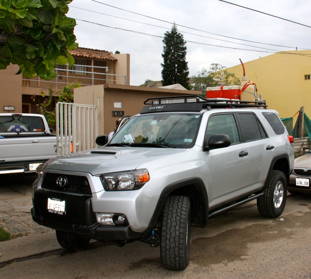

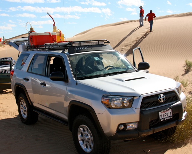

How is the light output on the bar? Is it a VisionX Xmitter? Did you have to modify anything to mount it? Some of the FJ guys had minor fitment issues.
You've got great taste in mods. I may be a little biased though :)
its vision x, i sent the measurements of the light to Gobi and they did the mount specifically for that light at no extra cost they were great, they even gave me the option of sending them the light and they would mount it, i read somewhere on this forum about someone complaining about the service in Gobi in my case costumer service was exceptionally good

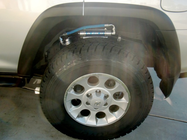

How did you mount the remote reservoir up front ? King sent me the new bracket that mounts up to the sway bar location, i am worried that this will interfere with the KDSS and washer fluid reservior
Very Cool looking Rig :bigok:
thanks for compliments, i did not do the install myself but on monday ill ask the guy that did the installation and let you know but i'm sure where he put them it does not interfere with the kdss but on drivers side i am getting some rub with tire ill let you know
